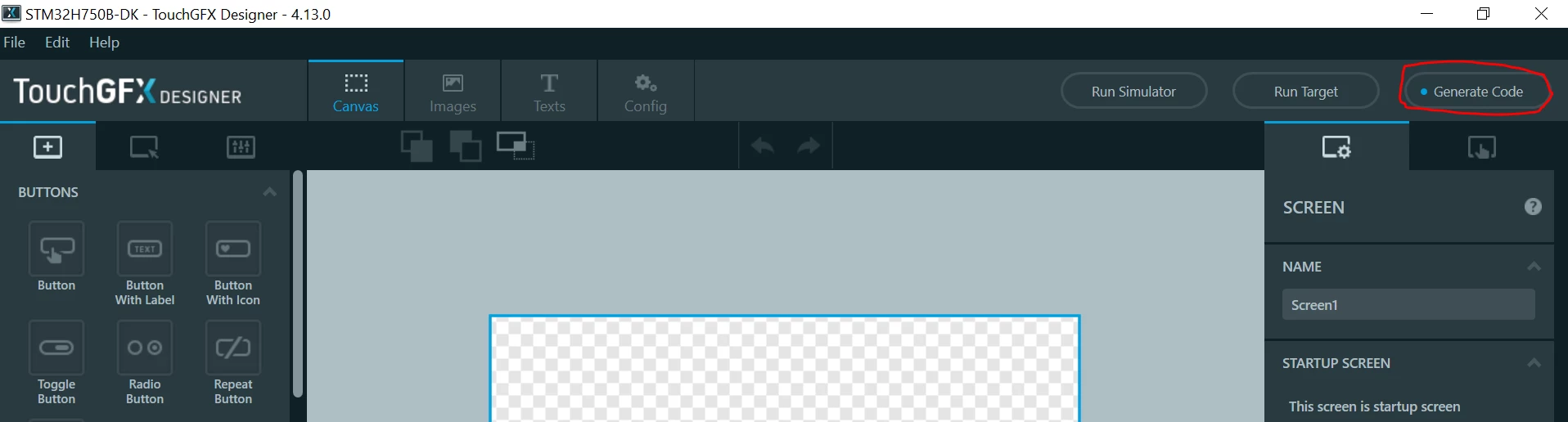

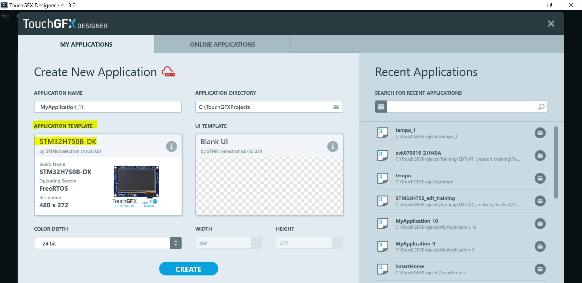

When you create a project from Designer you should select the right Application Template, so in your case the H750B-dk0693W000001sR7zQAE.pngThen click on the button Generate in the top right corner to generate all the files for you project.

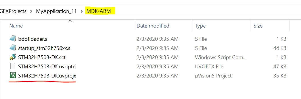

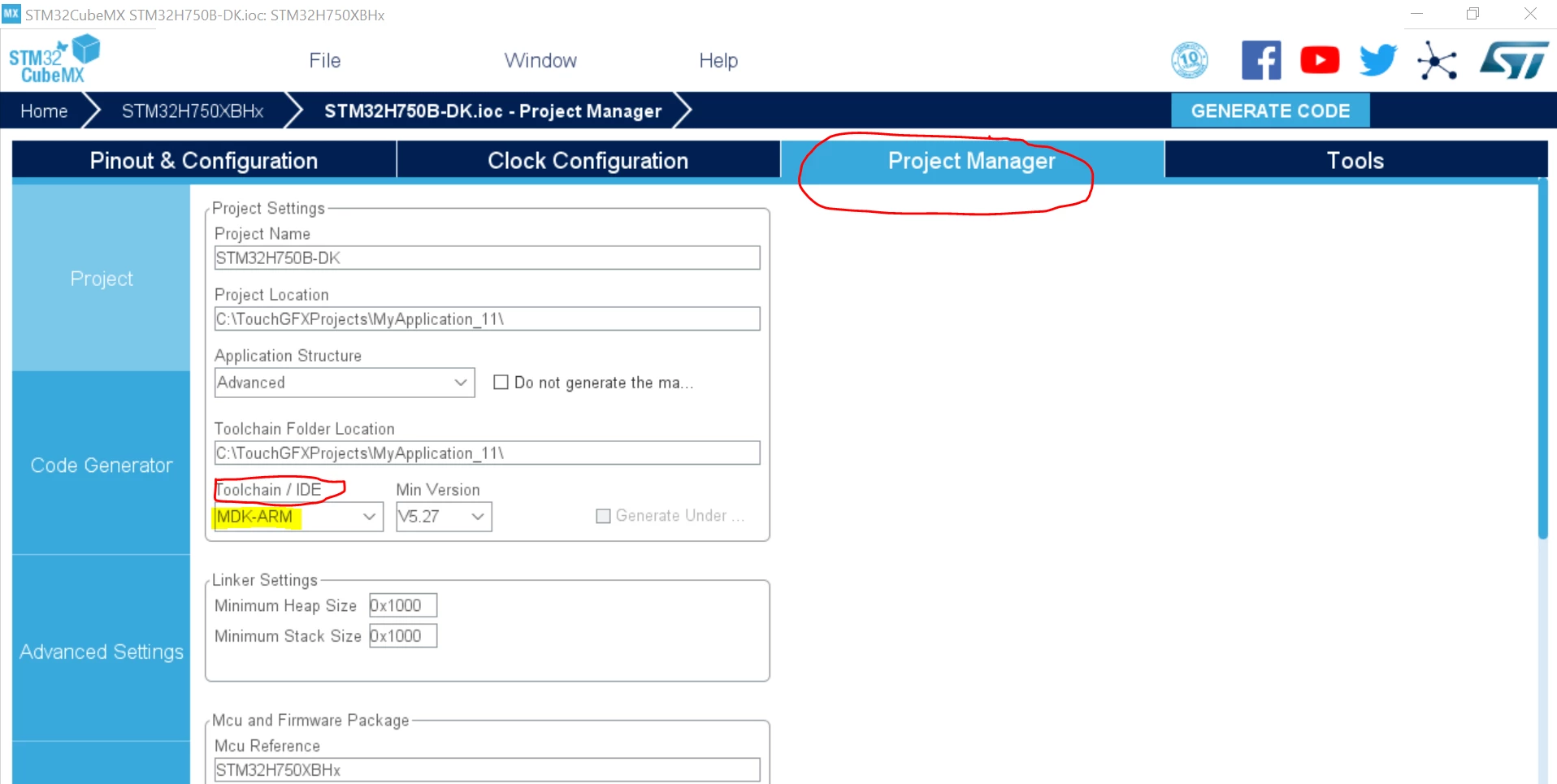

0693W000001sR8TQAU.pngNow if you go to the folder where you created your project you will see a MDK-ARM folder, this is where you will find the Keil project. But first you should open the ioc file (cubeMX project) to set the right toolchain. When you open the ioc file and arrive in CubeMX, go to the project manager tab. In the section "Toolchain / IDE" select MDK-ARM and then save (cntrl S) or generate code. This step is necessary when you change toolchains/IDE, and the initla IDE set is STM32CubeIDE0693W000001sRAoQAM.png
You can now debug/run your project with Keil by opening the uvprojx in the MDK-ARM folder in your project folder.
