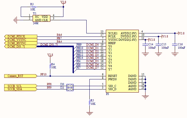

The Dragon407 has them on PH11/12 (all DCMI Dx pins are H/I banks)
The joys of low pin count STM32 parts, and that the F4-DISCO isn't a straight break-out board. The 100-pin devices are particularly frustrating. I'm using the 144-pin parts, as is the Dragon407. They *REALLY* should have used the 176-pin part, as it's still awfully clashy with the external FSMC (SRAM/NAND/LCD), Ethernet, USART, SDIO.

This is so Great ! I changed the solder jumpers to use c8 and c9 then used those pins within my app. From there I do a DCMI->DMA->Mem transfer, on completion of that the state changes and I do a Mem->DMA->Uart Transfer. From there I have a python app that pulls the data off the serial port and saves it as a file. I attached a 160x120image.

I've been trying to do this forever, about a year ago I was trying with a aptina sensor and gave up. There are so many paths to take when troubleshooting this stuff if you go down the wrong one it can set you back quite a bit.
Thanks for all the help.
