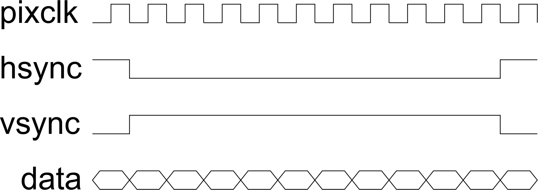

Hello there.
On my board I've setup DCMI to read some arbitrary data from ADC. I've planed to use JPEG mode to just capture all the raw data from ADC while HSYNC is in LOW state. There is my timing diagram:0693W00000HnXMLQA3.pngThe thing is I do not get FRAME interrupt nor any data in my destination buffer. The LINE and VSYNC Interrupts got triggered, but FRAME and ERROR or any of the DMA interrupts just never happening. For me it looks like pixclk is just ignored somehow, but is definately there. I've tryed setup DCMI by bare registers or by CUBEide.
Is there some common thing I've missed?
Initialization code:

Thanks
UPD:
Found in HAL Init() function flowing line:
/* Enable the Line, Vsync, Error and Overrun interrupts */
 __HAL_DCMI_ENABLE_IT(hdcmi, DCMI_IT_LINE | DCMI_IT_VSYNC | DCMI_IT_ERR | DCMI_IT_OVR);
For some reason FRAME_IF is simply not enabled. Hmm.... okay. Anyway, DMA is still does not seem to work.
UPD:
I've disconnected PIXCLK from MCU, but kept V/HSYNC signal inplace. LINE/VSYNC Interrupts stopped generation. Looks like PIXCLK going through DCMI.
UPD:
Tried to poll FNE bit of DCMI->SR register. It always stays at zero. This is all very stange. PIXCLK seems to work, but no data captured.
