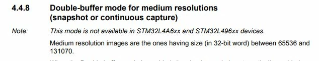

I try to make stm32l496 as a video camera device. I use Ov5640 sensor. The aim is that taking photos and send them to the host device directly (like a webcam).
The challenge is that when I try to use high resolutions, due to I don't use any memory, how I can handle it and send the data through otg? I want to use WVGA resolution (800x480) with JPEG format.

Hi @Jävad Maleki​ ,
For DCMI High resolution, you should use the Double-buffer mode.
But, the Double-buffer mode is not available in STM32L496 devices.
You can refer to the section "4.4.8 Double-buffer mode for medium resolutions (snapshot or continuous capture)" in this AN5020 Digital camera interface (DCMI) on STM32 MCUs

Hello @Javad,
You should consider some parameters like: the pixel clock, the supported data format...
Higher resolution require maximum DCMI pixel clock.
You can check the product datasheet, and I recommend that you refer to this AN5020 Digital camera interface (DCMI) on STM32 MCUs
that helps you on DCMI configuration.
