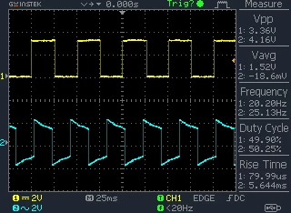

I am trying to run an application which captures incoming Y only image data on DCMI interface.
Pixel clk is 5MHz, field rate is 50Hz (PAL video), 8 bit luminance only data and discrete sync signals.
MCU is STM32F767IG and camera device is a TVO5150AM1 decoder.
The problem I am facing here is that DCMI capture rate is not as same as VSYNC signal.
In continues mode, When VSYNC frequency is 50Hz, DCMI captured fieldrate is 40Hz.
I had placed a toggle pin at VsyncEventCallback and FrameEventCallback to detect their rates. Yellow one represents Frame(field)rate while the blue one represents VSYNC frequency.
There are similar issues in snapshot mode which causes a frame to be captured from somewhere other that start of a line.
I have to add that it does not overrun, as no errorcallback is triggered.

OK, I have figured out something, but it's kinda strange. If I allocate more than 200KB for capture storage on internal SRAM, this strange behaviour occurs.
I don't know why, but this MCU has 512KB of SRAM, and I have not allocated RAM for any other variable yet.
