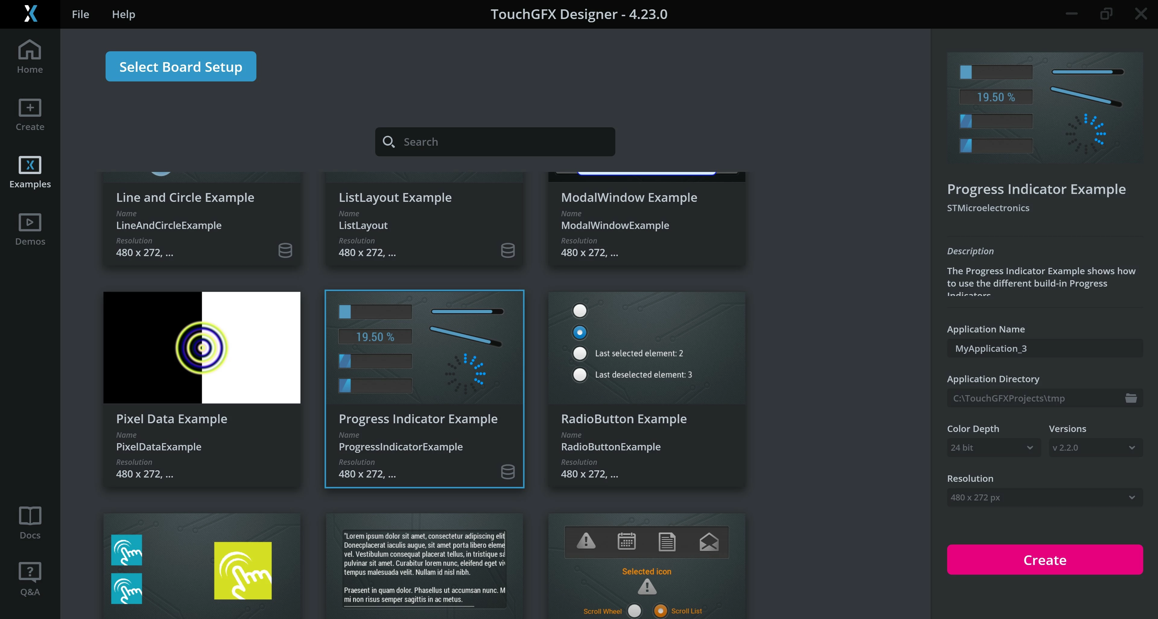

Hello @KNara.2 ,
There is a Progress Indicator example on TouchGFX which contains a circular indicator similar to the one you desire.
Progress Indicator ExampleProgress Indicator Example
Please consider checking it for inspiration and if you still need help, don't hesitate to ask.
