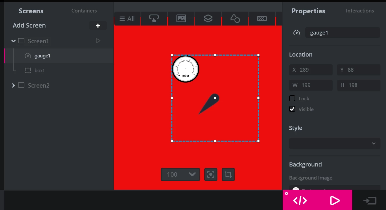

customize the gauge widget image, not in the right pixels.
I want to customize the gauge widget with my image.1- I drew an image on Coreldraw then exported PNG( image 199x198px )

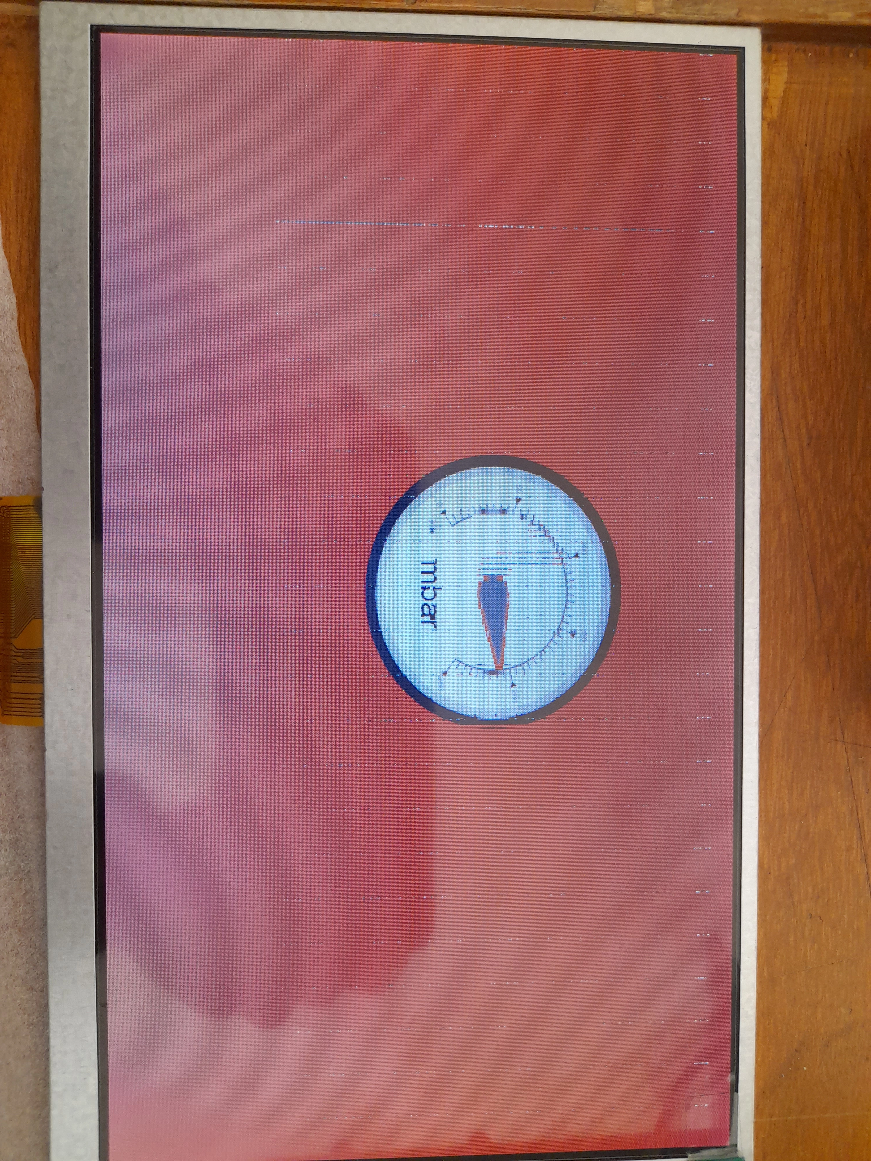

2- I used it in gauge background but it was not shown in real pixels in designer( gauge_gfxdesigner image ) 3- I programmed it on my board, the image was shown in right pixels on LCD ( gauge_lcd image) while using standard gauge styles in designer there is no such a problem.
what do I do wrong? How can I convert my image to be shown in right pixels?
thank you and best regards.

Hello @Zakba.1​ ,
What is the size of your image ?
Because the dimensions of the default gauge background image in TouchGFXDesigner are 251px * 251px.
So, if you want your new background image to fill the widget space, it also has to be 251px width and 251px height.
Otherwise, if you wanna keep a smaller background image, you will have to change the Needle image.
/Yoann

I drew 251*251 image in CorelDRAW and exported it I had the same problem. would you plz teach me how to make an image for gauge?
