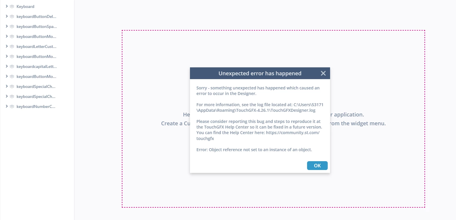

I have a problem with my custom container. I made a custom keyboard container in my project (4.26.1 compile is ok). I would like use this in another project.
I exported this container which works.
In the another project i import the widget, but compiler get unexpected error.
What is the problem with widget?
Thank you!

2026-06-19 09:15:01,186 [1] ERROR TouchGFXDesigner.App: Object reference not set to an instance of an object.
System.NullReferenceException: Object reference not set to an instance of an object.
   at TouchGFXDomainModel.LoadSave.Serial.ToSerial.Convert(TriggerCustom t)
   at TouchGFXDomainModel.LoadSave.Serial.ToSerial.Convert(Interaction i)

The problem was that when I exported the keyboard, there were multiple fonts for the keyboard. I renamed them to TypogrphyKeyboard1 and 2. That way I can import them into another project.
