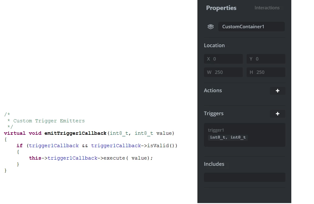

Custom-Trigger more than one type
Is it possible to create 2 or more types in a custom trigger? i tried it with a komma, but i doesn't work.0693W00000Y7TxMQAV.png

Hello @Roman REITER​,
Yes, that is possible.
Select <custom> as your Action type and rename whatever you want (in my example I named it ThreeThings):
0693W00000Y7Z8jQAF.pngIn the Includes tab, create a struct and insert your variables, with different types if you want, like this :
0693W00000Y7ZA1QAN.pngThen, you can link an interaction with your Custom Trigger, e.g. :
I attach my TouchGFX project example to this post, so you can look at it in details if you want.
/Yoann

Thanks, but I knew that. would have thought of something like this: <custom>, <custom>
Yoann KLEIN
Jan 11, 2023 1:24 PM UTC
I'm not sure to fully understand, why doing that when you can just pass a struct with as much parameters as you want ?
/Yoann
Yoann KLEINST Software Developer | TouchGFX
Roman REITER
Jan 23, 2023 11:34 AM UTC
mostly an array with size is passed to functions (2 parameters-char * array, uint8_t size). i just wanted to do it the way it is done (as shown in books). However thank you for your help.
