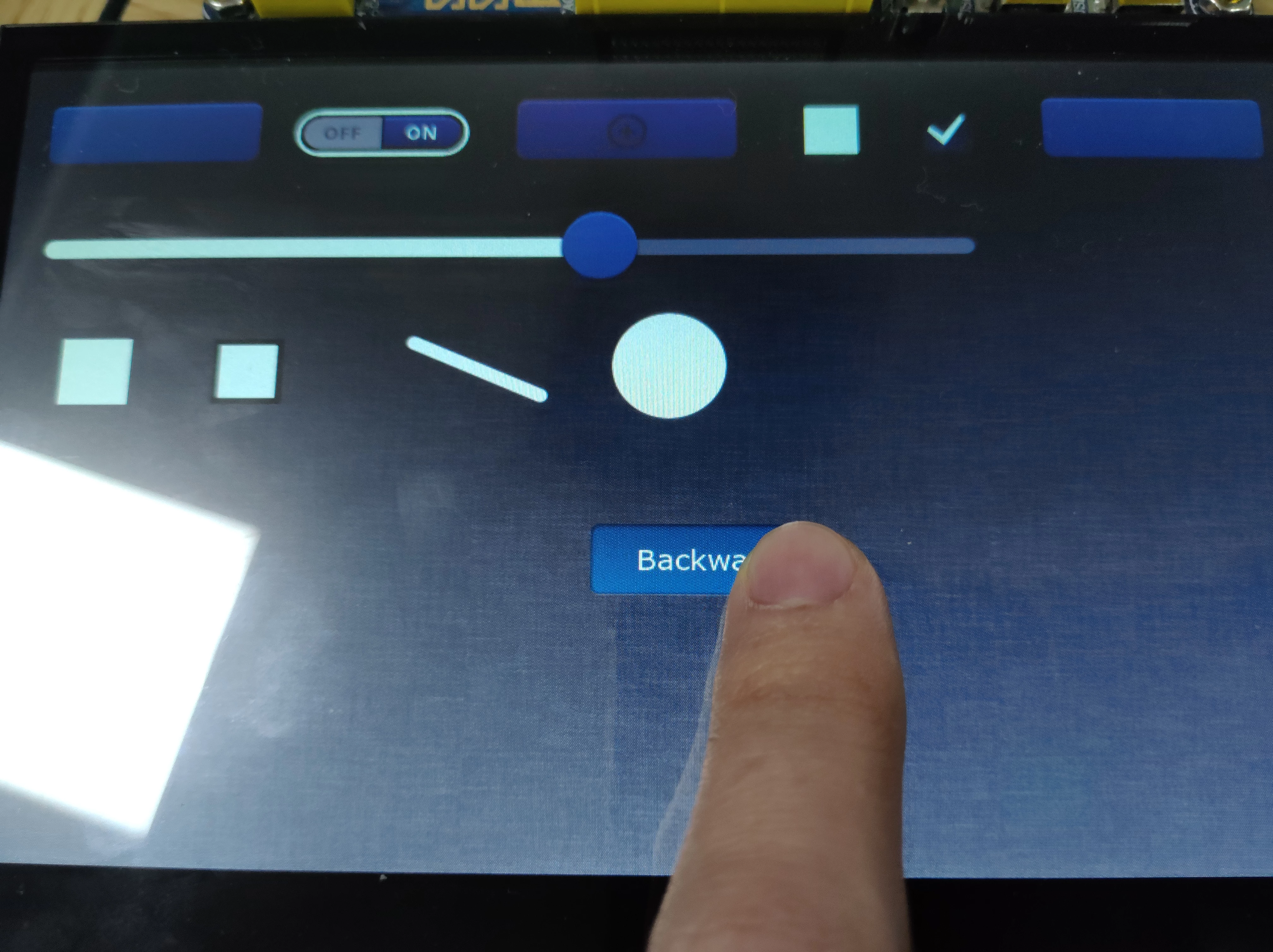

0690X000006CnjYQAS.jpgThis is not a question asking post, just something I want to share. Hope will help people who meet the same problems I solved.
Last I asked lots of question about how to build a TouchGFX project.
You can find the original ask in [Does CubeMX 5.0.0 Ready to Build a TouchGFX Project?]
https://community.st.com/s/question/0D50X0000A1kKWaSQM/does-cubemx-500-ready-to-build-a-touchgfx-project
After few weeks work, I finally make this right. Now I'd like to share some information with you.

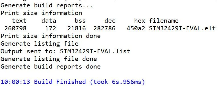

I use the "Board Selector" way in CubeMX and choose a STM32429I-EVAL board as the project template. Then I turn off the peripherals which do not relate to Graphic function, such as USB, ETH and so on. Since I can't find the parameters of LCD panel (AM-480272H3TMQW-T01H) which is use by STM32429I-EVAL, I am not sure the settings in LTDC is right. But the project is built correctly.
elguezzar
December 13, 2018
hi @Zhi Pang​ ,

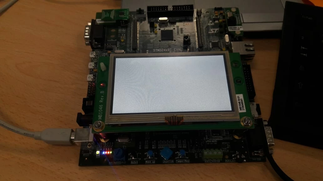

i rebuilt your project in Atollic, i generated Hex file, and i flashed my Eval board but nothing displayed on LCD 0690X000006ConGQAS.jpg
Zhi Pang
Zhi PangAuthor
December 13, 2018
Hi @elguezzar​
I think the LTDC is not being initialize​d correctly.
In the project I offered, the MX_LCD_Init() function is located in \Application\User\TouchGFX\target\HW_Init.cpp.
You need to compare it with the official demo's LCD_Init() function which is located in \STM32Cube_FW_F4_V1.23.0\Projects\STM324x9I_EVAL\Demonstrations\TouchGFX\Gui\target\BoardConfiguration.cpp.
Since I don't have a EVAL board, I can't verify the project if it is fully functional or not for you.

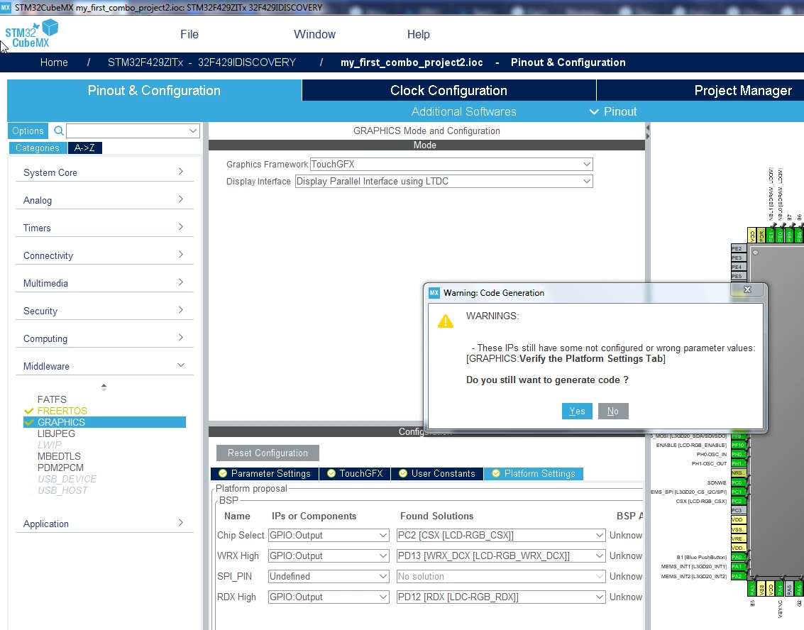

Hi. Here is the first draft document of the full procedure to support the STM32F429i-DISC1 target that we followed:
https://s3.amazonaws.com/axxonshare/my_combo_tutorial.zip
Welcome your feedback on the document and if it works for you. Good luck! :grinning_face:
