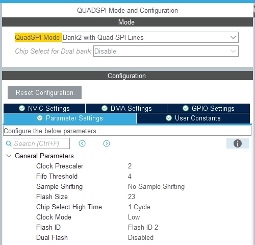

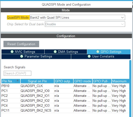

My processor is an STM32L496VGT6 and its connected via quadSPI to an MT25QL128A 16MB external flash memory. I'm running the clock at 80MHz, and my QUADSPI is setup like this (both in my custom loader, and in the application code I'm developing):

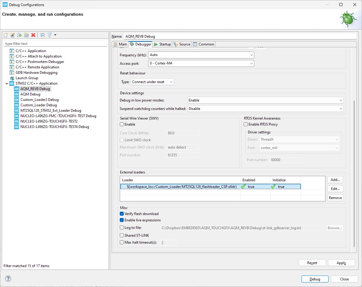

Where my problem begins is when I attempt to use the new external loader I generated in my debug sessions while trying to develop my main application. Here I've gone into the debug sessions, pointed to my generated loader file, and started to debug.
With the external loader enabled as above, the code stops on the first use of:
HAL_Delay(1);
If I drill down a little with the debugger, the code is stuck within HAL_Delay() in the while loop:
__weak void HAL_Delay(uint32_t Delay)
uint32_t tickstart = HAL_GetTick();
uint32_t wait = Delay;
/* Add a period to guaranty minimum wait */
if (wait < HAL_MAX_DELAY)
 wait += (uint32_t)uwTickFreq;
while ((HAL_GetTick() - tickstart) < wait) // <===== STUCK HERE!
Where HAL_GetTick() constantly returns 0, which doesn't seem right.
When I disable the external loader, everything goes back to working fine. What do I check next? Is my external loader really just not working in some untested way? Or is there some initialization I need to do in my main() initialization when using an external loader? Or maybe some deinitialization I didn't do in my loader?

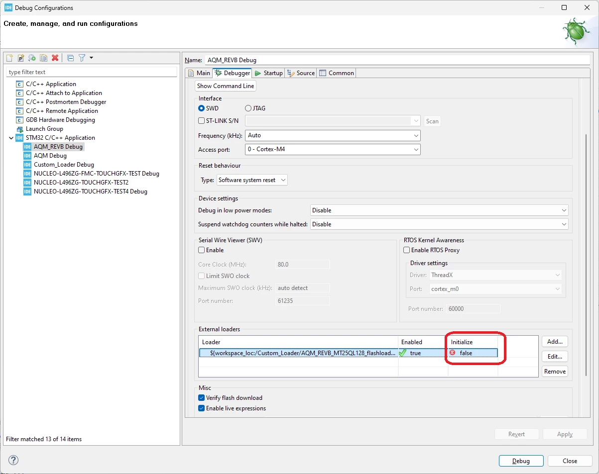

Best answer by BWKidd
Holy Carp!
My external loader was more or less working all along. I just needed to not have "initialize" checked in the external loader debug settings.
An ST field applications engineer took a look at it and that was all it was. I'll try to post a follow up with a few more details on Monday, but that was pretty much it. Many thanks for those of you who offered advice, and a special thanks to @Tesla DeLorean for trying to help me work through it.

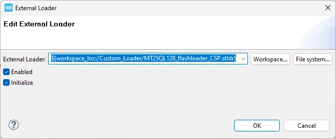

April 1, 2025
Hi @Abhiram_12 Abhiram_12,
Unfortunately its been a while since i've looked at this and I've only done it once, so hopefully someone more experienced can weigh in here, but my experience was that I needed to have that "initialize" checkbox left un-checked. If you check it, I think your main application attempts to initialize based on the init function in your loader, which almost certainly what you don't want. So if I understand your question properly, then the answer is you definitely want to leave "initialize" un-checked in your debug options for the external loader.
