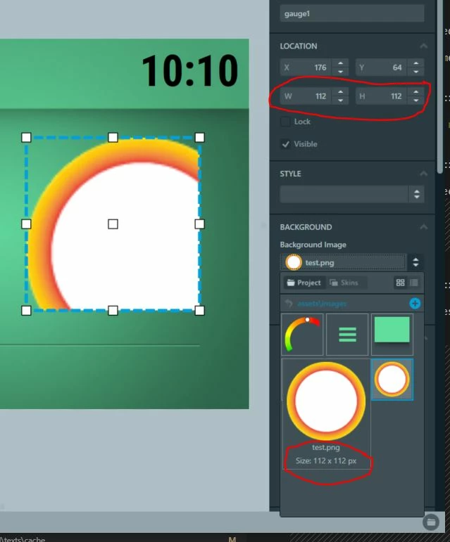

I've just upgraded to version 4.16 of TouchGFX and noticed an issue with the new gauge widget.
When I use a custom background image it does not get displayed correctly inside the application. It's displayed somewhat "zoomed in". I've attached a screen shot showing the issue.
My background image is 112x112, and the widget is 112x112, however as you can see from the screenshot the image does not fit within the bounds of the widget.
It's worth noting that the image does render correctly on the actual target hardware (I haven't tried the simulator).
Is this a bug? Or have I missed one of the settings?

Hello Simon Sq,
It's quite interesting. Thank you for reporting it. However on my side I don't reproduce it.
Could you enclose the image so that I can try with your image and see if it happens ?

Hello Simon Sq,
I managed to reproduce your issue with the full circle image you provided. I'm currently investigating.
Could you tell me how you got this picture ? This might help us understand why it behaves like this. We need to find the root cause before I can tell the dev team to make a fix ;)
/Alexandre
Alexandre RENOUX
Visitor II
January 6, 2021
I believe your picture is somewhat corrupted with wrong data inside.
I managed to have a good behavior with an image based on the one you sent and with 112x112 pixel in size

Thanks for this information - I have tried it and it does resolve the problem. My original image was generated using Adobe Illustrator CS6 and was exported at 72dpi.
I think I may have found the root cause of the issue. I tried a similar thing to you in that I did the following:
  1. Opened one of the skin gauge images that ships with touchgfx in Photoshop
  2. Deleted its contents to have only a transparent background
  3. Resized to fit my image
  4. Pasted the contents of my original file into a new layer
  5. Save file
And viola it worked. But, what I then discovered was when resizing the image (step 3) I noticed Photoshop indicated the image was at 96dpi, where as my original image from Illustrator was reported as 72dpi.
Now I don't know what this would make a difference, dpi has no real meaning in the context of touchgfx, but it does seems to make a difference. Perhaps there is something in the touchgfx designer code that assumes the images are at 96dpi? I still find it strange that all images appear correctly in the Image widget, but not the gauge - which I understand uses an Image widget to display the background.
So I don't think my image is corrupted, but it seems the dpi of the image when created causes a problem in the designer.
