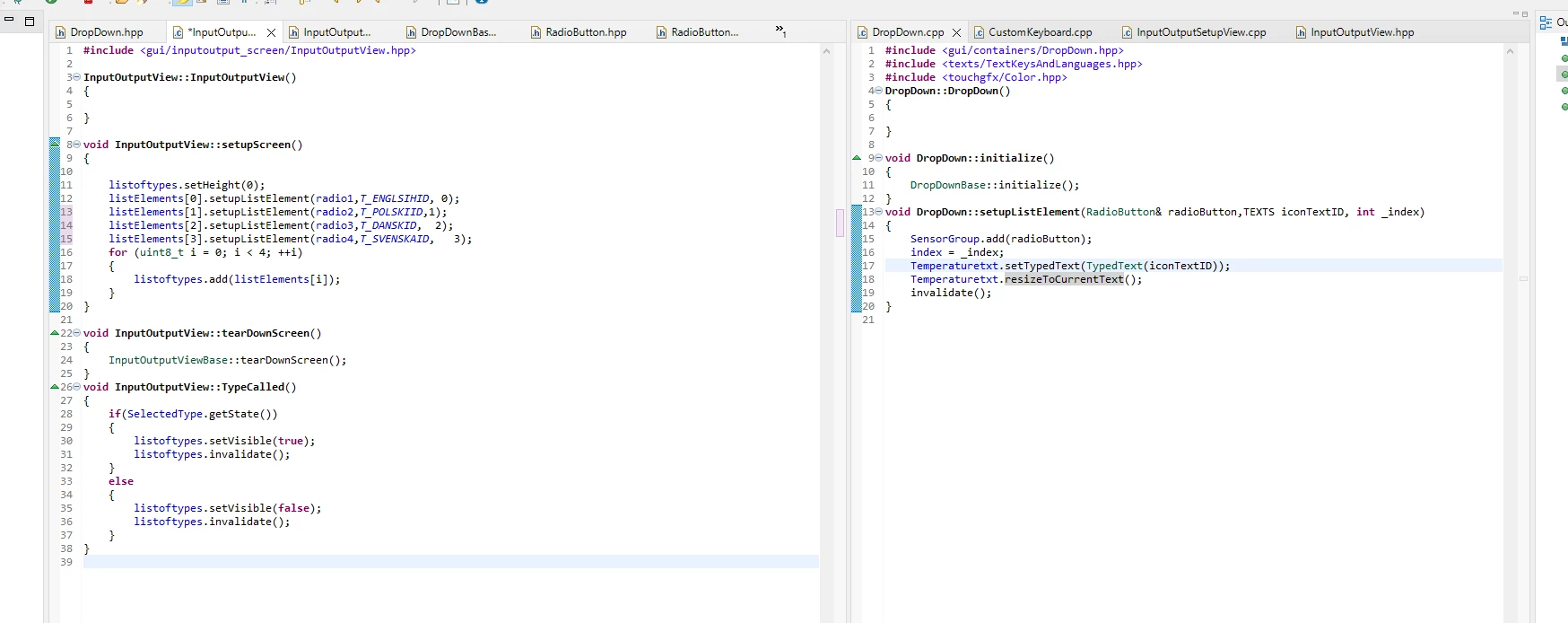

Ok. First of all I create one radio button in custom container:
0693W00000WJQLpQAP.pngThen I write this code in my custom container:
#include <gui/containers/example.hpp>
example::example()
void example::setupListElement(TEXTS iconTextID, int _index)
	index = _index;
	languagetxt.setTypedText(TypedText(iconTextID));
	languagetxt.resizeToCurrentText();
 invalidate();
int example::getIndex()
	return index;
Then I put that container in my screen window: Screen1
0693W00000WJQVGQA5.pngMy Screen1 code looks like that:
#include <gui/screen1_screen/Screen1View.hpp>
#include <texts/TextKeysAndLanguages.hpp>
Screen1View::Screen1View()
void Screen1View::setupScreen()
	list.setHeight(0);
	listElements[0].setupListElement(T_ENGLSIHID, 0);
 listElements[1].setupListElement(T_POLSKIID,1);
 listElements[2].setupListElement(T_DANSKID, 2);
 listElements[3].setupListElement(T_SVENSKAID, 3);
	for (uint8_t i = 0; i < numberOfListElements; ++i)
		list.add(listElements[i]);
void Screen1View::tearDownScreen()
 Screen1ViewBase::tearDownScreen();
void Screen1View::examplebuttoncalled()
	if(examples.getState())
		scrollableContainer1.setVisible(true);
		scrollableContainer1.invalidate();
	else
		scrollableContainer1.setVisible(false);
Start simulator and click on toggle button we see dropdown
0693W00000WJQVaQAP.pngIf I click for example english and polski it selects both of them(as usually if all buttons are in one group then if I click one option deselects another and so on).0693W00000WJQYFQA5.png So the question is this how to add all radio buttons in one group programmatically? In this project I use a lot of dropdowns and I need to create them dinammically because it allocate a lot of microprocessor memory.

Do you check if all your radio button are on the same group ?

I've tried do like this, but still does not work. Do you have any suggestions?

What does your callback method look like ?
I mean the method which is called when you click on your radio buttons?
