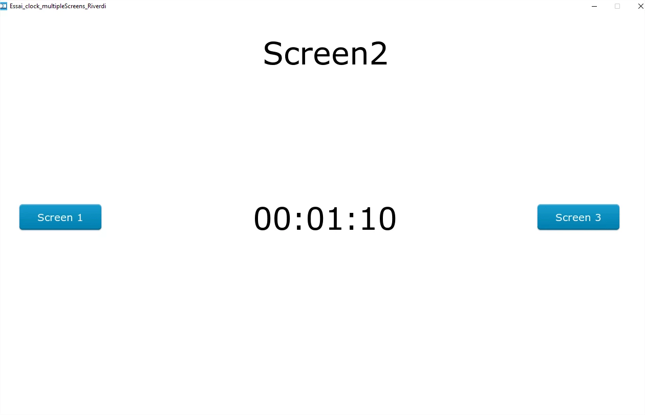

Jul 26, 2022 1:30 PM UTC
Hello @Yoann KLEIN​ ,
Sure, here's some screencaps of the simulator.
Yes the propagation works fine, it's the clock I set that has a problem. I set with my fakehardware the clock to 08:25:36 in screen1.
0693W00000QMB8OQAX.png It stays at that time for 1 second then it reverts back to 00:00:010693W00000QMB8iQAH.pngFrom there it continues counting like it should
0693W00000QMB9HQAX.pngWhen I change the screens it propagates well.
0693W00000QMB9RQAX.png0693W00000QMB9WQAX.pngBut that's not the time I wanted to set at the beginning. I wanted to start at 08:25:36 and start counting from there → 08:25:37 instead of 00:00:01
Kind regards,
Eve
