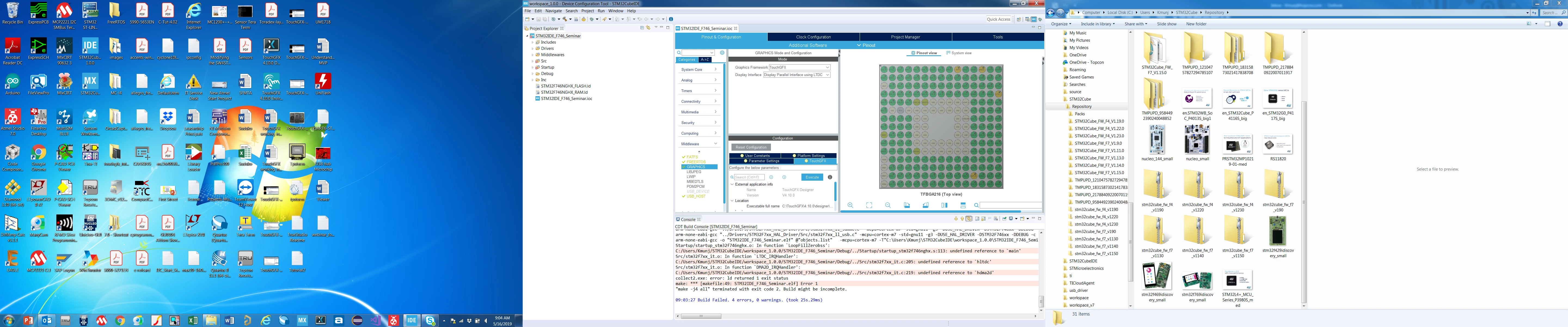

KMunj
May 16, 2019 4:23 PM UTC
​I tried STM32CUBEIDE and 32F746NGDISCO. I enabled TouchGFX and do a build (without executing TouchGFX).
I get build errors as shown in attachment. I hope ST fixes these issues, since if you start with TouchGFX, you can do GUI very well. But I have lots of sensors and wireless connectivity.  It's not easy to integrate the rest of the system code with TouchGFX code. I had it working with SW4STM32 and CUBEMX4.0. But now moved to CUBEMX5.2 and it doesn't work any more with SW4STM32.
Thanks
Kiran
Martin KJELDSEN
Principal III
May 24, 2019 12:49 PM UTC
You're building a C project, but TouchGFX is C++ so you have undefined references to symbols that come from cpp files (which don't get compiled).
