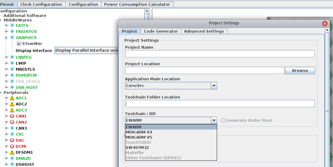

Project generation in CubeMX is great. Atollic now that it is free is great. STEmWin is.... ok.
I'd like to generate STemWin based projects with CubeMX while using the Atollic IDE.
As some of you might know, when you ENABLE GRAPHICS in the Pinout,  TrueStudio as the IDE to generate the project for is not available in the project output.
Wondering if anyone at ST has an ETA when TrueStudio / Atollic will be supported?0690X0000060BP6QAM.png

As of today, CubeMX 4.26.0 now supports TrueSTUDIO with graphics.

Hi Richard,
When I enabled STemWin in GRAPHICS, the TrueSTUDIO selection in Project - Settings - toolchain / IDE drop list still be grey.
CubeMX 4.27.0
STM32Cube FW_F4 V1.21.0
Is just V4.26.0 support that feature and V4.27.0 don't? Or it's depend on FW?
