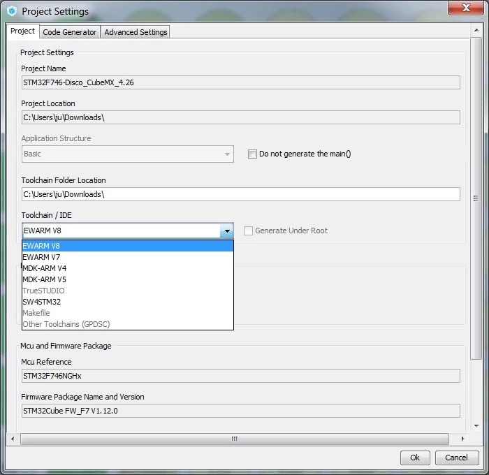

Hello
I'm building a first app to explore STem. I'm doing it the easy way :
eval F746 and CubeMX.
It appears that if I enable STem, Atollic is no more supported as IDE.
(see screenshot).
Is it a regular behaviour?
If yes, can you communicate a reason and is there any plan to provide this
feature in the future (target date) ?
Thanks
Julien

Hello @Julien D_Oevillers​ ,
We confirm this limitation and it will be fixed in next STM32CubeMx release.
Sorry for the inconvenience it may bring and thank you for your comprehension.

OK. Any release date planned?
