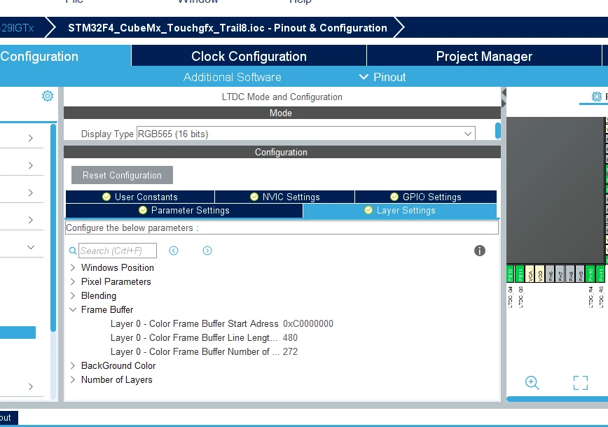

I am using a custom board with STM32F429IGT, and 480X272 TFT screen which are wired to LTDC Pins . The TFT part number is K430WQA-V4-F.
I built a Project using CubeMxVer 5.1 and Touchgfx Ver 4.1.
Compiled and downloaded the code in the board after removing the simulator files in the code.
In the Touchgfx ,made a application with two screens each having one image ,which toggle every 1 sec.
When , I run the code, the display is blank.The Touchgfx is not updating the screen and toggling the screen.
The hardware is working good . I checked this by manually updating the framebuffer start address in the HW_Init.cpp file to a picture address i used in the touchgfx application.
But if i keep the Framebuffer start address as 0x0000000 in the cubemx and generate the file again , the screen is blank.
Dont know what is missing

your framebuffer start address should be 0xC0000000

I tried 0xC0000000. But the screen is blank. Is this address we can choose by our own?

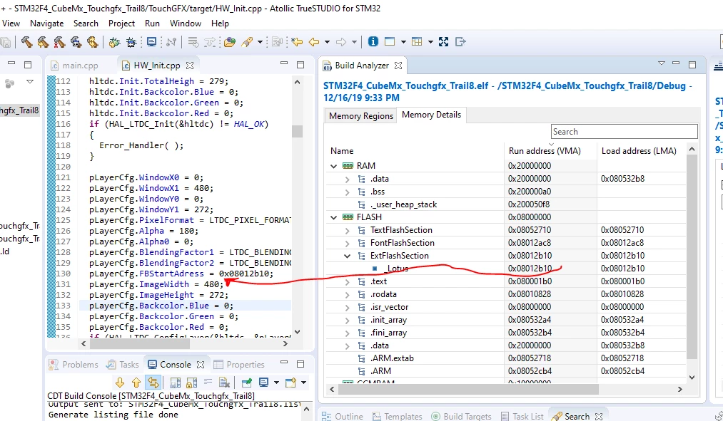

"Hardware is working good" - Could you elaborate on what you mean by that?
Are you receiving interrupts from the LTDC to drive TouchGFX?

I guess hardware is working good because when i Place the pLayerCfg.FBStartAdress = 0x08012b10 in the HW_Init.cpp file ,then i can see the image on my tft screen .see the snapshotbelow.
But i am expecting that when the osKernelStart(); is executed in the main.cpp , the tft screen should be showing the images from the touchgfx .But it is not.
I used different values of start frame buffer address in cubemx.but nothing helps.0690X00000BugWAQAZ.png
I have done similar setup in DISCOVERY STM32F429 EVAL BRD . It works very good in the DISCOVERY board ,but doesnot works on my custom board.
