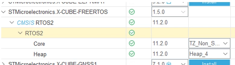

In GfxDesigner 4.26.1, I created a blank project for STM32U5G9J-DK2.
I opened it in CubeMX 6.17 and tried to migrate FreeRTOS. However, when I changed CUBE-FREERTOS version from 1.0.1 to 1.5.0, the freeRTOS version did not change from 10.4.6 to 11.2.0.
Why ? Is this expected behaviour ?
Thanks for help.

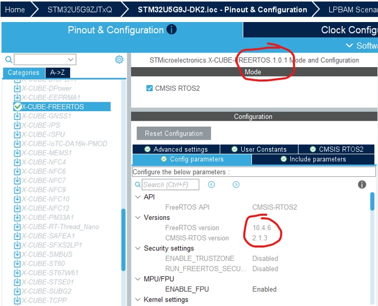

X-CUBE-FREERTOS-1.0.1   (FreeRTOS version 10.4.6)

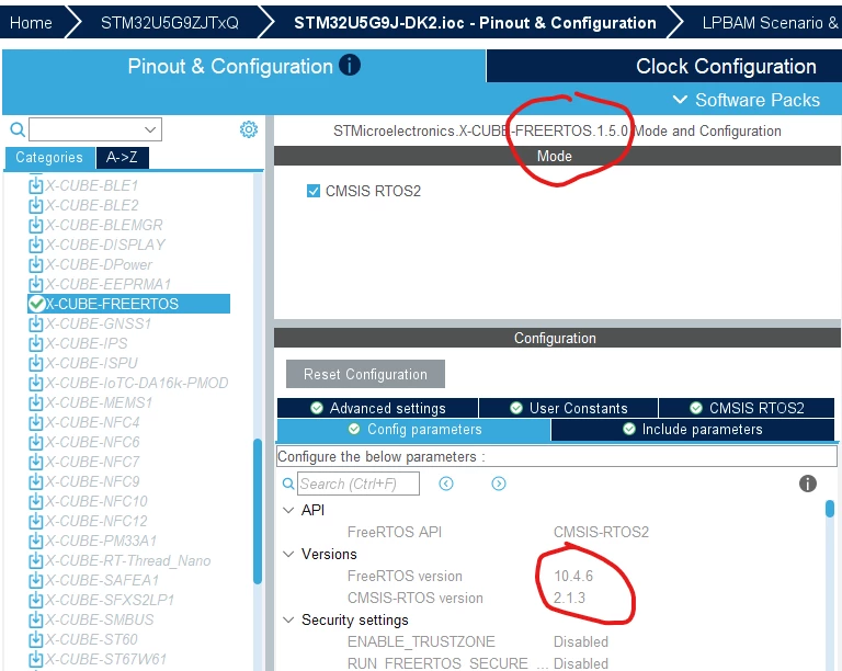

I migrate to newer version
X-CUBE-FREERTOS-1.5.0   (FreeRTOS version 11.2.0)
But version did not change from 10.4.6 to 11.2.0

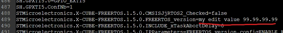

This does not work on my machine. I found out that the displayed version is number/string assigned to
TMicroelectronics.X-CUBE-FREERTOS.1.5.0.FREERTOS_version
variable.

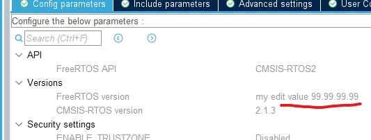

I change that string manually and it is displayed as the version.
