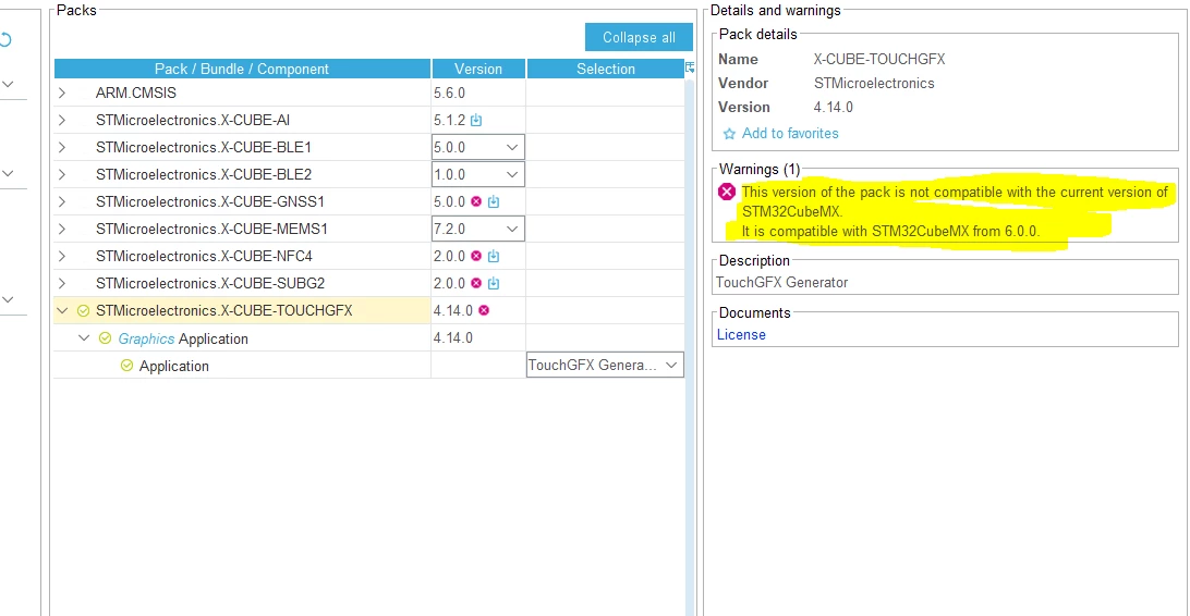

CubeMX 5.6.1 and TouchGFX 4.14
  • July 30, 2020
  • 1 reply
  • 1148 views
What is required to link the version of the additional packages with the version of the CubeMX. Version 6 has a lot of problems that make it practically unusable. I returned version 5.6.1 which works stably, but here's what message it gives me? You are trying to return the TouchGFX version as well but obviously I have to uninstall it manually because I couldn't uninstall it from the Cube.

Digging this up to know if you have made the move to 6.0.1 or if you kept working on 5.6.
I am surprised by the way that you had to uninstall TouchGFX, since if you used 4.13 previously it should still be an option. On your picture you cannot select it but by disabling touchGFX generator in the Application tab in your picture, the scroll option is enabled and you can chose 4.13 instead of 4.14.
