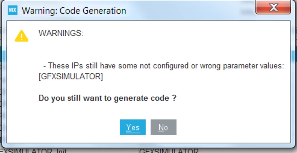

Clark Sann
Mar 13, 2019 4:17 PM UTC
How do you get around this error?
This occurs when Generate Code within CubeMX 5.1.0

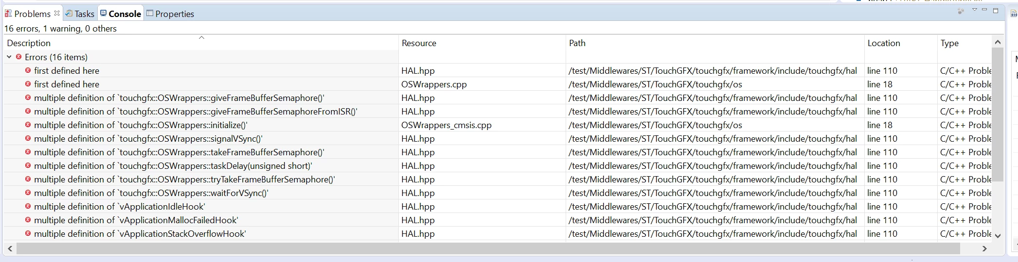

Carl Farrington
Mar 25, 2019 12:01 AM UTC
I am having similar problems.
Should there be a separate TouchGFX distribution which doesn't include the simulator stuff, for CubeMX use ?
I installed TouchGFX separately, first, and then CubeMX, but I'm having all these same problems.
and after removing the simulator and sdl stuff myself, I have different problems:
