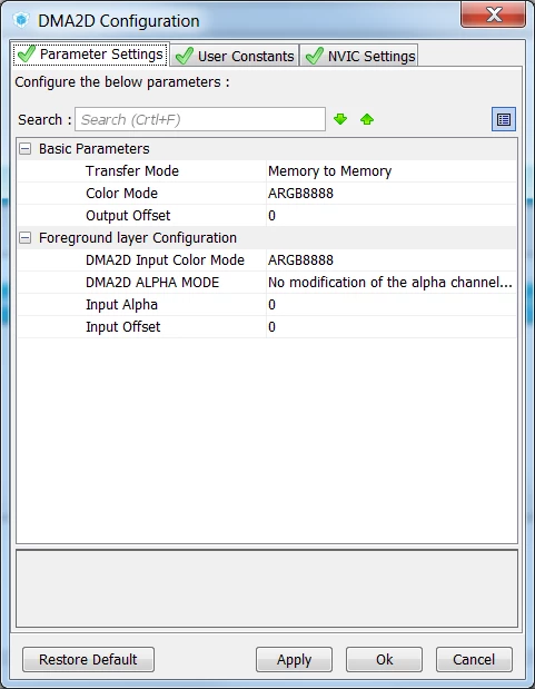

Can you please provide the ioc file for your F746 project?
CubeMX 4.22 does not provide the possibility to configure the Alpha inversion and Red&Blue swap parameters since they are not available for this MCU:
While indeed it is available for other series (ex: F767x):
