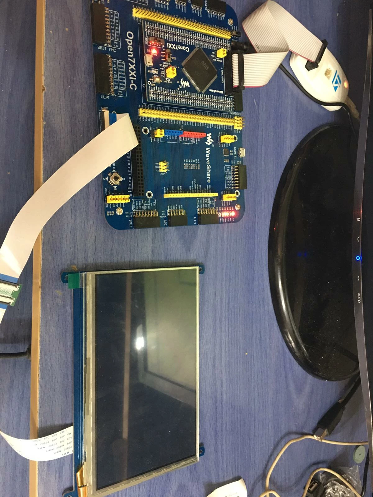

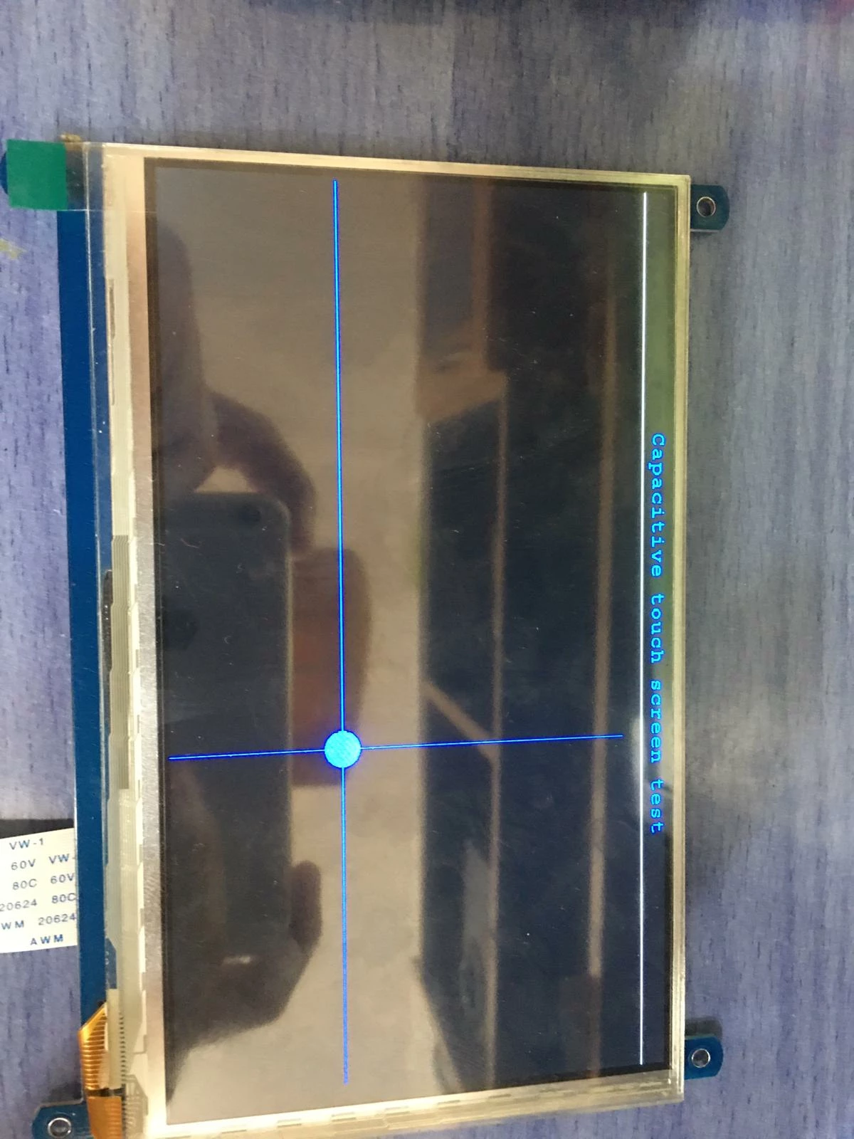

Hello, I'm developing a project on stm32f746igt6. I use open746-c (stm32f746igt6) board. I could not create a project that works with cubeide. the screen is solid black. If I load the demo code that came with open746-c. The screen works. My connections are correct. Is there a sample cubeide and touchgfx project file for open746? I looked at other question titles. I couldn't find any solution. There are custom board videos with stm32f746g discovery but not enough.
Demo Code Working
The project created with cubeide and touchgfx does not work.
pins are defined according to the board.
Best Regards

Thank you for the answer. I was able to print pictures on the screen with the code I produced with Cubemx. When I include touchgfx in the project, the screen is black again. I noticed while debugging with Led.
MX_TouchGFX_Process(); // it does not exit this loop when it is processed.
HAL_GPIO_WritePin(GPIOB, GPIO_PIN_6, GPIO_PIN_SET); // so the led does not light up.

0 error 0 warning> The screen is black when I load the code. Do I need to make special settings?
I also debudged. mx_touchgfx_process (); I created a breakpoint. I did not receive any errors in the window that opened.
