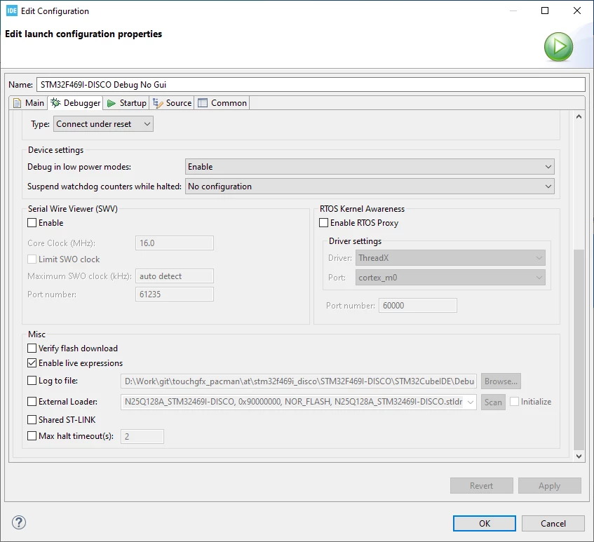

Cube IDE - Long Loading Time with Graphics.
When debugging with Cube IDE programs without any TouchGFX graphics load quickly using the debugger typically 20 to 30 seconds. When TouchGFX is used such that the NOR Quad SPI Flash has to load the loading time can easily exceed 3 minutes. With only a singles simple screen it takes ~60 seconds.
I assumed that if nothing is changes in the graphics from one debug session to another then there would be no changes required in the external graphics flash and so the loading of this memory is unnecessary after it has been loaded once.
I therefore turned off the external loaded in the debugger setup:
However when I tried this I got the following error:
Error in final launch sequence:
Failed to execute MI command:
load G:\\ShorttG2\\ShorttG2\\STM32CubeIDE\\Debug\\STM32H7B3I_DISCO.elf
Error message from debugger back end:
Load failed
Load failed
Load failed
Load failed
Would it be possible to avoid redundant graphics loads in some way to shorten up the debugging turn-around time?

wired
Senior II
Apr 27, 2022 7:55 PM UTC
The best way to do this is to create a new launch configuration in your Run/Debug settings. In addition to my Debug configuration, I have a similar one called Debug No GUI. In this configuration, you go to the Debugger tab and uncheck the External Loader Checkbox in the Misc group (you need to scroll down to see it).
0693W00000LzFlSQAV.pngAnother nice thing you can do is if you want to run the debugger in low power modes, you can Enable that in the Device Settings group on the same dialog. I actually have 4 debugging configurations:
GUI with LPM
GUI wo LPM
No GUI with LPM
No GUI wo LPM
If I have changed anything in the GUI, I simply select my 'GUI wo LPM' Launch Configuration.
wired
Senior II
Apr 27, 2022 7:58 PM UTC
Looking closer at your post, I see you already tried that. This works fine in CubeIDE with my STM32F469i-DISCO board. Not sure why you had a problem...

wired
Senior II
May 3, 2022 5:44 PM UTC
Rob,
I thought of your problem today when I got a Failed to Execute MI command error. I sometimes get these because STM32CubeIDE has the annoying 'feature' of enabling the Resume button before you have reached your breakpoint in main(). I sometimes am not paying close attention, and hit the Resume button before the debugger has loaded the code and stopped at the first instruction in main(). This results in the MI error and the failure to debug. I then have to start all over.
I wonder if this might have happened to you?
