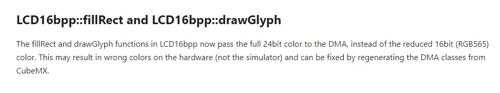

Critical bug: After update to 4.18.0 colors are incorrect on Hardware, but "Run Simulation" still works as expected
Here an example from the hardware
but in Run Simulation:
0693W00000GXAyLQAX.pngWe are using
 touchgfx::TextAreaWithOneWildcard
and the colors are wrong when we do not use 255,255,255 and 0,0,0. Only these two colors work
We use the following colors, and it is causing problems. In Run Simulation, everything works as expected
These are the color codes we use
 //red color
 RGBred = 193;
 RGBgreen = 39;
 RGBblue = 45;
 //blue color
 RGBred = 112;
 RGBgreen = 144;
 RGBblue = 183;
 //yellow color
 RGBred = 240;
 RGBgreen = 217;
 RGBblue = 92;
 //orange color
 RGBred = 232;
 RGBgreen = 166;
 blue = 71;
Please help!!!
We use icons with the exact same colors. They are fine! But only texts that touchgfx colors, are not correct. Again not all texts, just texts which are not 0,0,0 and not 255,255,255

What MCU are you working with ? Could you try generating code from STM32CubeMX again ?
/Romain
VSimu.1
VSimu.1Author
Nov 11, 2021 9:57 AM UTC
It seems this is a "known issue". For anybody else seeing this "issue"
https://support.touchgfx.com/4.18/docs/miscellaneous/known-issues

a) We were able to fix our issue by updating to the latest STM32F7DMA.cpp file
