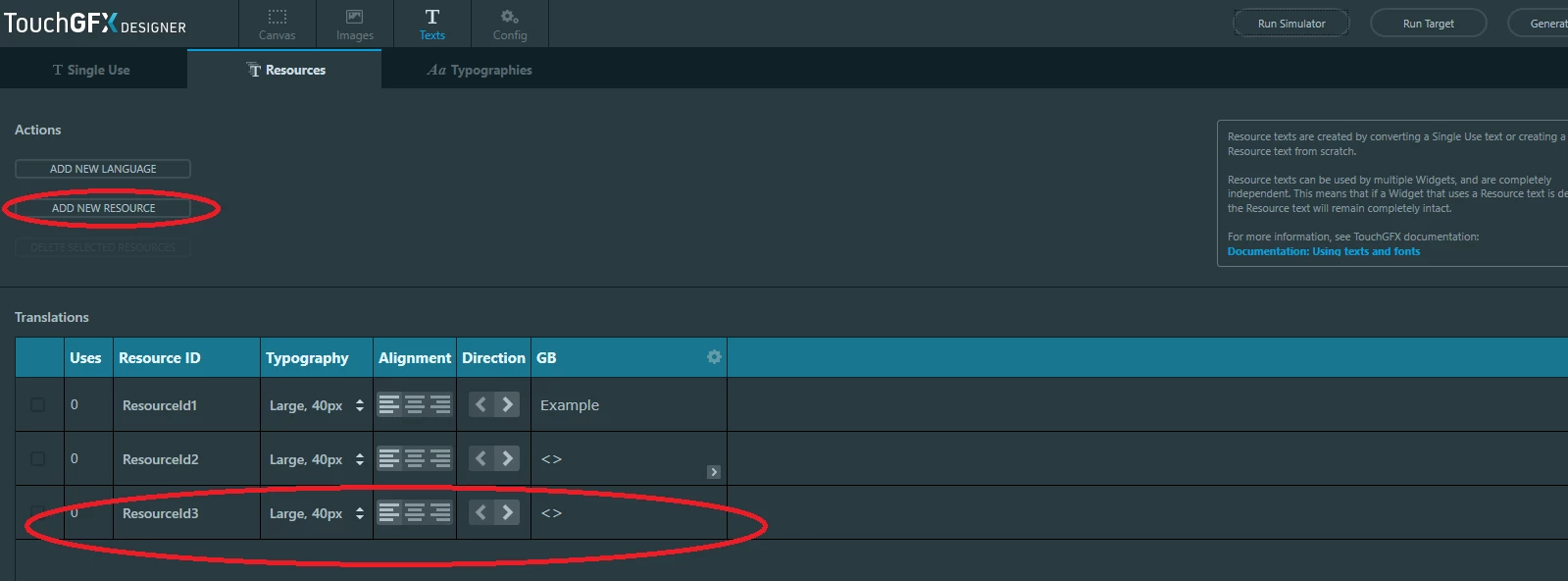

FULL SOLUTION TO CREATING CUSTOM TEXTAREA WITH CODE
With the help of everyone participating in this post and some other people in other threads (and, of course, my own undeniable genius *chuckle*), here is a summary of how you can create a textArea purely (99%) with code. Step by step from zero:

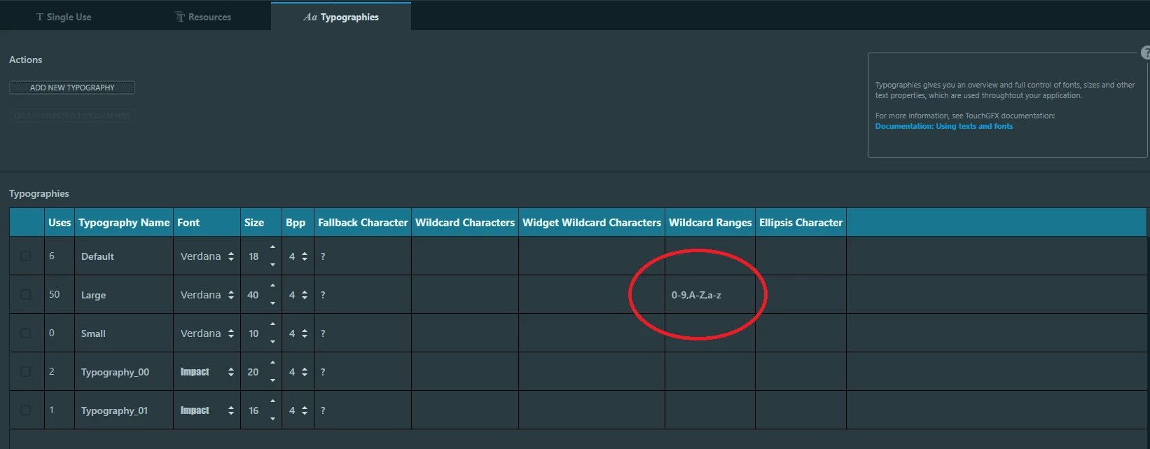

Open TouchGFX Designer. In the upper tabs, go to "Texts"->Typographies. Make sure there is a font you are going to use (or add another one), you need to generate letter glyphs using TouchGFX Designer. In my case, I did this:0693W00000BcRuBQAV.pngI'm using Verdana 40px font; In "Wildcard ranges" I have written 0-9,A-Z,a-z; this will force TouchGFX to generate glyphs for all letters and numbers even if no TextAreas created natively in TouchGFX Designer use them. Otherwise, you can miss a few letters of that font (and will see "?"). If you need other characters, such as commas and stuff, there is "wildcard characters" section for it.
Next, go to "Resources" tab. "Resource" is a set of formatting rules that we associate with every TextArea. Font size, font direction, Alignment and content. Add new resource to use with the new TextAreas that we will create with the code. You can use one Resource with multiple TextAreas. It's just a formatting feature, not the text itself. I am going to use "ResourceId3" for my custom TextAreas. Set the Typography of the Resource to the one you used in 1.In Resource text, write "<>" (means "wildcard"), If you write some text in there except "<>", it will be visible in all TextAreas using that resource. Wildcards, however, are individual for every TextArea. Personally, I want all TextAreas to have completely different content, so I do the following:0693W00000BcS0JQAV.png
Now we have forced TouchGFX to generate all characters' glyphs for the font we're going to use and we have created text formatting rules, also known as Resource (Rules are: use that font with glyphs, align left, text direction left to right, text is entirely wildcard). So we finally get to generating stuff with the code.

Next, we do the funny "Unicode::snprintf(testTextAreaBuffer, 10, "Meow meow");" This actually puts the string "Meow meow" into the buffer and adds termination character at the end so you don't have to worry about it. This function actually defines what TextArea shows. "10" is a buffer length. You can have a string of 1 character but have buffer length 10, the function will take care of it.
Then I decided to resize the TextArea, but you can set fixed width of course, it's all in TouchGFX documentation online. I just wanted to see all, since I'm doing proof of concept here.
Then I add textArea to the screen. It could very well be container1.add or something else.
And then invalidate() forces TouchGFX to redraw the widget to make it show up to date content of the buffer. If you want to change the content of TextArea, you do Unicode::snprintf(testTextAreaBuffer, 10, "New Text"); followed by invalidate().
The second TextArea does exactly the same; it has the same Resource but its own buffer array.
I have a semi-opaque background box on the screen, other than that, the result is the following:
Congrats, that's it!
