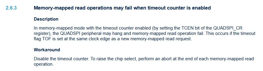

Update: I disabled the QSPI timeout counter as mentioned in the device errata and the problem appears to have gone away.

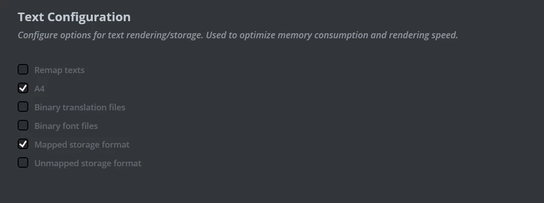

  • Which storage format do you have checked on "Text Configuration" inside TouchGFX Designer ?
  • Can you share with us your TouchGFXConfiguration.cpp file ?

Mapped storage format
posted a file.
