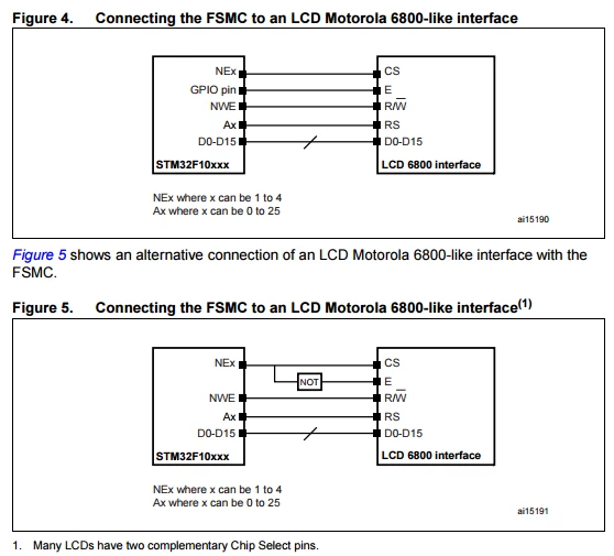

I want to use STM32 to drive a LCM with a KS0108 controller. Sadly, it has a 6800 interface. Fortunately, ST gives a document to guide me:
http://www.st.com/content/ccc/resource/technical/document/application_note/85/ad/ef/0f/a3/a6/49/9a/CD00201397.pdf/files/CD00201397.pdf/jcr:content/translations/en.CD00201397.pdf
 . In p. 12 it gives two methods:0690X00000606P6QAI.png

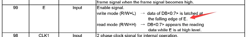

But the
http://www.techtoys.com.hk/Displays/JHD12864J/ks0108.pdf
, states when write to LCD, the data is latched at the falling edge of ''E'':
Then, assuming we use the method 1 above, the pseudo-code should like:
lcd_addr = lcd_data;
gpio_E = LOW;
After the first clause, the /CS should goes to high, what's the state of the data bus, will it hold the data last output??? Or it will go to high impedance after /CS high? How can we make sure the LCM to latch the correct data?
For method 2, the situation should be similar.
Anyone ever tried ST's method?

IMO the FSMC in STM32 is not capable of true Motorola-style interface.
I'd manually bit-bang it, especially since there are only 512 bytes of memory in that LCD. With a bit of imagination, timer-triggered-DMA could be used for some degree of automation.
