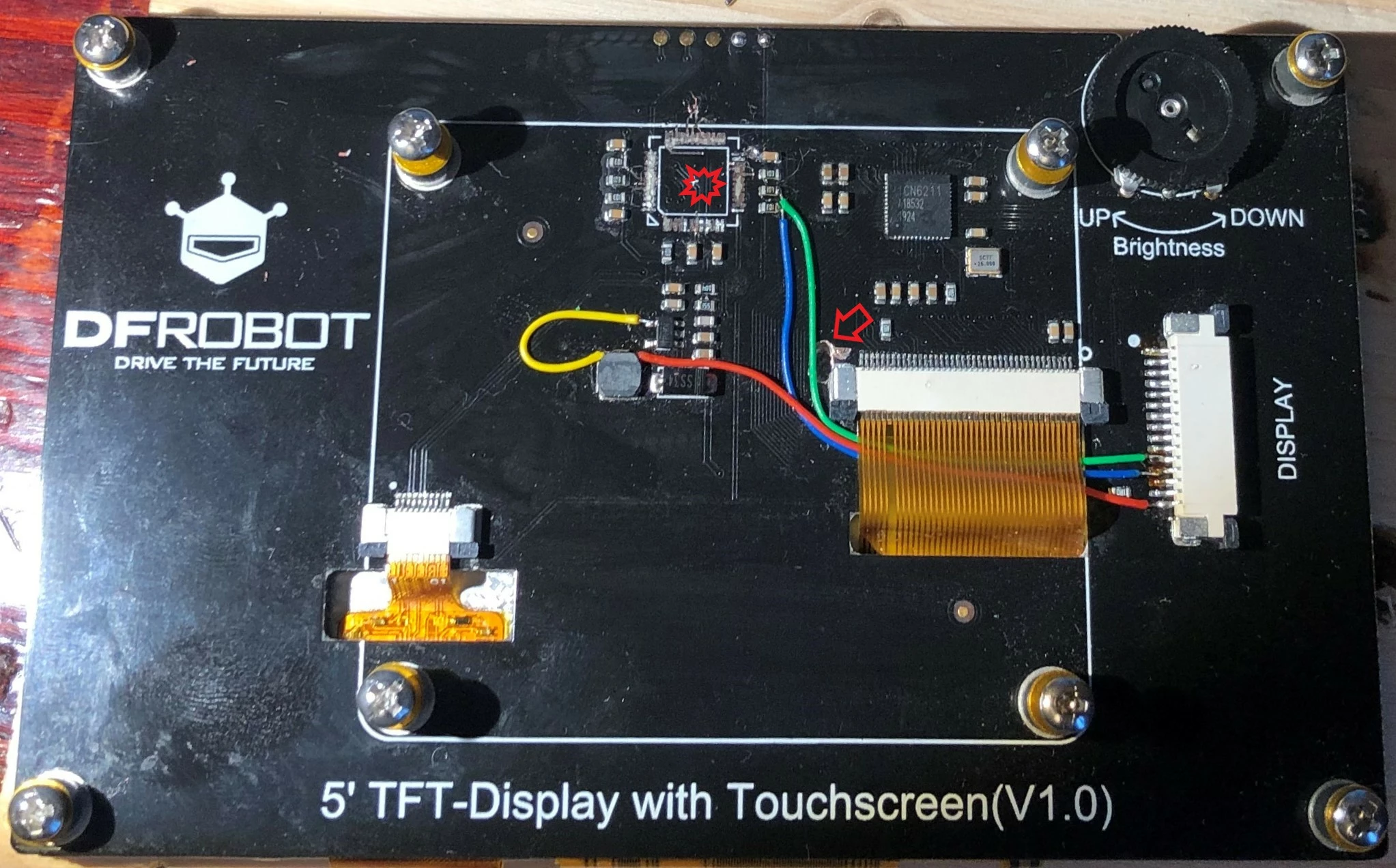

Hi @Karan Kolhe​ I have not succeeded yet. The problem is RPI displays are heavily protected.
1) Typically ICN6211 MIPI-DSI chip is used, no specs publicly available. However, lots of information can be found in Linux kernel forums. Based on this, I put configurator tool available here.
2) In addition to MIPI-DSI RPI displays use I2C communication for display config and touch. This communication is obfuscated. Note RPI displays contain some MPU, typically STM32F103. Probably the only purpose of this chip is to protect RPI secrets. What one can do is simply de-solder this chip and connect I2C lines (touch control and ICN6211. Doing so I have partially succeeded, I am able to communicate with ICN6211 and put in in test mode, display control screen, receive touch data. I have not succeeded yet configuring STM32F769 for ICN6211. If you do, please share the details/demo. For now I use MIPI parallel interface.

@Karan Kolhe​ MIPI parallel interface (LTDC) is well documented. OTM8009a is not a problem, that is also well documented.
However, that is not a typical RPI display - and that is problematic due to lack of documentation and protection techniques used.
How I got it partially working? I took DF Robot DFR0550 display, desoldered STM32F103 chip, connected I2C lines directly (green and blue wires) and voila!
I also had to hard-enable step-up voltage converter (yellow wire), red wire was not needed - it connects the VDD track I broke for test drilling a hole next to display connector.
This Linux driver looks promising. Any success yet?
