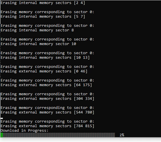

I download it how do I upload it to stm32
slimaniAuthor
April 5, 2025

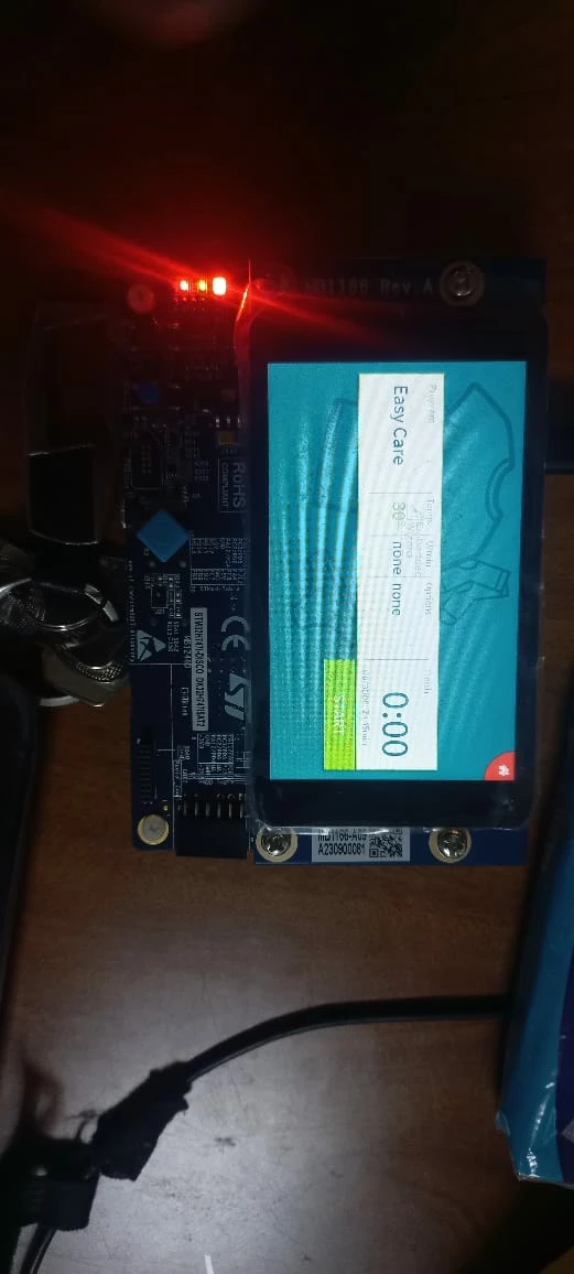

slimaniAuthor
April 5, 2025
finally it works

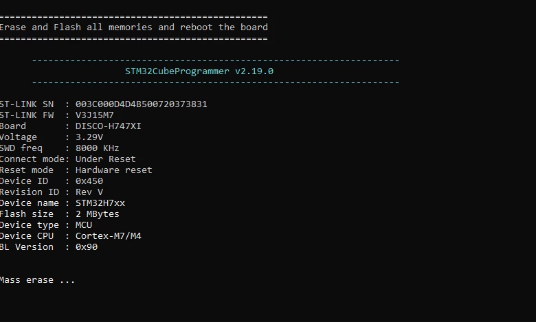

mƎALLEm
Technical Moderator
April 5, 2025
Now did you try the generated TouchGFX project?
Note: don't start a debug session. Just upload the two applications CM4 and CM7 disconnect and reconnect the STLINK USB cable again.

slimaniAuthor
April 6, 2025
No, my problem is not solved. I didn't understand the cause of this problem. When I create a project with TouchGFX and upload it to the STM32, the screen remains black and doesn't light up. However, when I upload the demo project you gave me, the screen works correctly.

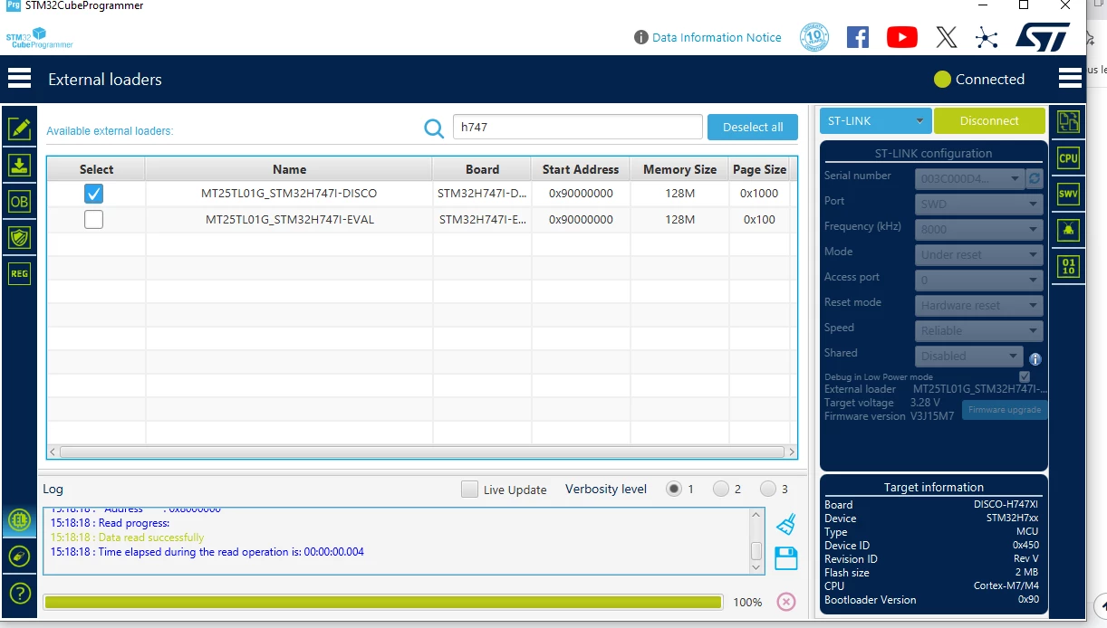

slimaniAuthor
April 6, 2025
I didn't understand your answer correctly but I opened stmprogrammer and I found this file and I clicked on connect, what is this file for? Is it for you to upload this file and then I upload the project if it explains to you what exactly needs to be done?
mƎALLEm
Technical Moderator
April 6, 2025
This the flashloader used by STM32CubeProgrammer to upload the external Flash (QuadSPI). The quad SPI flash contains the TouchGFX assets: images, texts etc..
Select that Flash loader then upload the two hex files as I mentionned before. Did you see somthing on the screen?
slimaniAuthor
April 6, 2025
I uploaded the two .hex files from CM7 and CM4 but the screen remains black and does not light up. The screen only lights up when I upload the demo project. I don't understand the cause of this.
