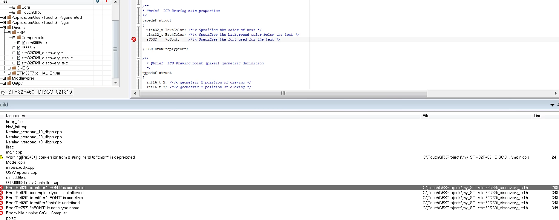

Hi. Following this document:
https://touchgfx.zendesk.com/hc/en-us/articles/360020208091-Configuring-STM32F769I-DISCO
and believe all the required changes have been made including applying comments to exclude the STM32 fonts as per this article. However, IAR compiler is raising font related errors.
Any suggestions for a fix? Will review this procedure again to hopefully locate my fault but welcome all feedback. Thanks.

Hi @Mon2​,
I will double check the article. From your compiler errors it looks like either an include is missing or some code is there that shouldn't be (We do not use or need the standard drawing methods provided by _lcd.c)
You could try to simply remove that code for now that the compiler is complaining about. If it's related to lcd drawing methods (sFont, drawRect, etc) you can just ommit it since it is not used by TouchGFX.
Sorry for the trouble!

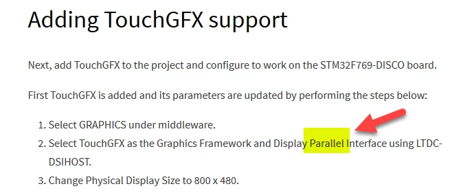

More errors that have been caught:
In the project add a sub-group under Drivers called BSP and add the three files stm32f769i_discovery.cstm32f769i_discovery_qspi.c and stm32f769i_discovery_ts.c which is located in STM32F7Cube installation folder, [STM32F7Cube]Drivers/BSP/STM32769i-Discovery and the file ft5336.c located in [STM32F7Cube]/Drivers/BSP/Components/ft6x06 ???
No such option - should read as "Serial"

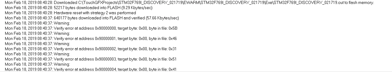

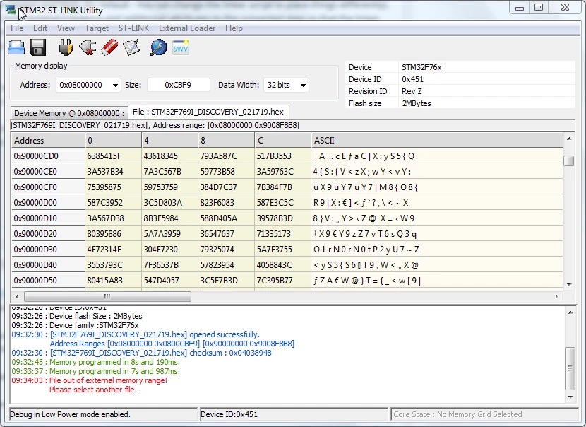

1) TouchGFX as a stand alone is using the gcc compiler and perform many hidden tricks. Where can we locate the final compiled binary file that is used to reflash the target memory on the kit? Guess we can study the make file. We wish to confirm that we are truly programming the entire memory ranges of the main memory AND the QSPI flash.
2) What is the role of the QSPI flash? Does the QSPI flash hold the compiled assets? Does IAR upload the final .hex file to both the main flash AND the QSPI flash? Do not think this is working.
3) ST Link utility does not appear to access the QSPI flash. While we can upload the .hex file that is generated by IAR using PROGRAM, the external QSPI flash reports that the file is out of range. Will study the Intel hex file to see if the range of the QSPI is included.
22:17:10 : [STM32F769I_DISCOVERY_021719.hex] opened successfully.
 Address Ranges [0x08000000 0x0800CBCD] [0x90000000 0x9008F8B8]
22:17:10 : [STM32F769I_DISCOVERY_021719.hex] checksum : 0x04036EBD
22:17:22 : Memory programmed in 8s and 721ms.
Does the above confirm that the QSPI region has been programmed?

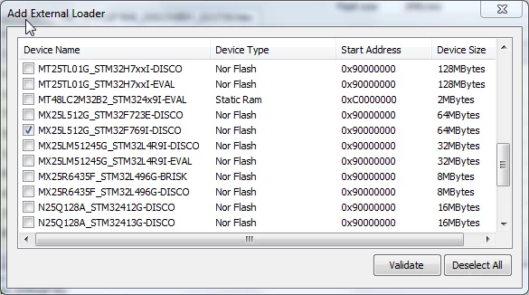

We have added the onboard QSPI flash as EXTERNAL LOADER but how do we upload to this memory region using the IAR compiled code?

1) "Where can we locate the final compiled binary?"
Yes, this is confusing. I've flagged this already but i'm not sure it'll make it for next release. It's inside (For v2.0.0 of the application template) TouchGFX/Build/bin/. There you can find both elf and hex files for internal flash (code only) and external flash (assets) and the full binary for both internal and external flash. For v1.0.0 it will just be build/bin.
2) "What is the role of the QSPI flash?
The QSPI holds images and texts (By default - You can change the linker script to place things differently). The converter tools append a pragma and additional attributes to the converted data so that the linker will place it correctly). e.g. LOCATION_EXTFLASH_PRAGMA and LOCATION_EXTFLASH_ATTRIBUTE. A config file in touchgfx will define these differently depending on the compiler.
e.g. for the IAR linker script - The TouchGFX config file for EWARM tags images and texts with ExtFlashSection:
define QSPI_region .... //0x90000000 to 0x93000000
place in QSPI_region { section ExtFlashSection };
3) (Minus the log part)
"ST Link utility does not appear to access the QSPI flash. "
You must add the external flashloader for your board manually. I think you said you did this? Then it will recognize that it can program 0x90000000->. Are you sure you've added the right flashloader?

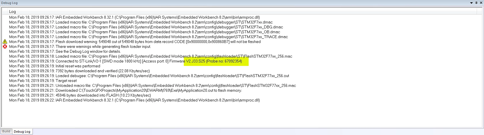

@Martin KJELDSEN​ , "getting closer" - have a scrambled graphic of my GUI page and/or a view of someone who has had too much to drink :)
Does IAR require special config for the external flash device? We did add the external loader QSPI flash with the ST Link utility but have not been able to upload to it using the .hex file.

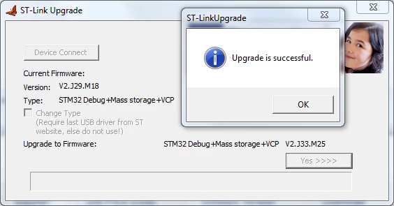

Also, our kit was on an older ST firmware - just reflashed to version 33
IAR is raising errors:
Mon2
Mon2Author
Senior III
February 18, 2019
Sorry - ignore for now - just noted that we are uploading code from YESTERDAY but testing a new code run....
:( St Link still complains with the new fresh .hex file that is posted below. Welcome feedback.
Hi @Martin KJELDSEN​ , here is what we see with the ST Link utility which we believe is properly defined for the external QSPI flash. Is the DISCO board the same as the Discovery Board? It is the same looking board as shown in your TouchGFX start menu.
So we know that IAR does not like the external flash region and now the ST Link does not appear to be programming the mapped external flash as well? However, the .hex file appears to be complete for our compiled code.
