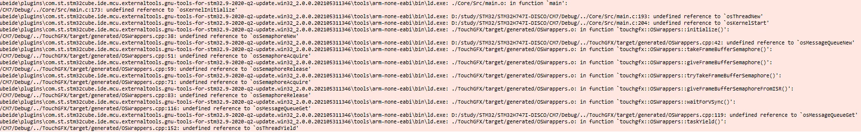

I have compile problems with STM32CubeIDE.
< Detail information >
1) STM32CubeIDE version : 1.7.0
2) TouchGFX version : 4.17.0
3) Target Board : STM32H747I-DISCO
4) Process order in my case
  • Create new STM32 project (select STM32H747I-DISCO board, targeted language is C++)

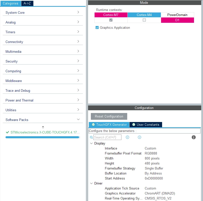

  • GUI design from TouchGFX program (open ApplicationTemplate.touchgfx.part)
  • Generate code
  • Refresh ​STM32 project and copy necessary files From TouchGFX project to STM32 project
  • Build project (in my case, compile error occurs)

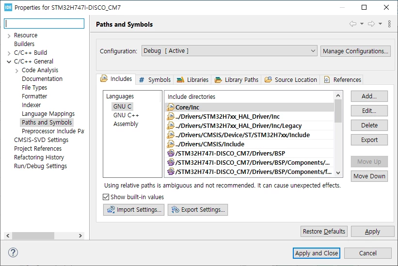

Attached my project.
Please advise for me, thanks.

It seems to me you could figure this out by following page 2 of the attachment. Meanwhile, I would suggest you to disable binary generation as shown in page 3 so you do not need to spend much time waiting for big binary (>2GB) generation.
