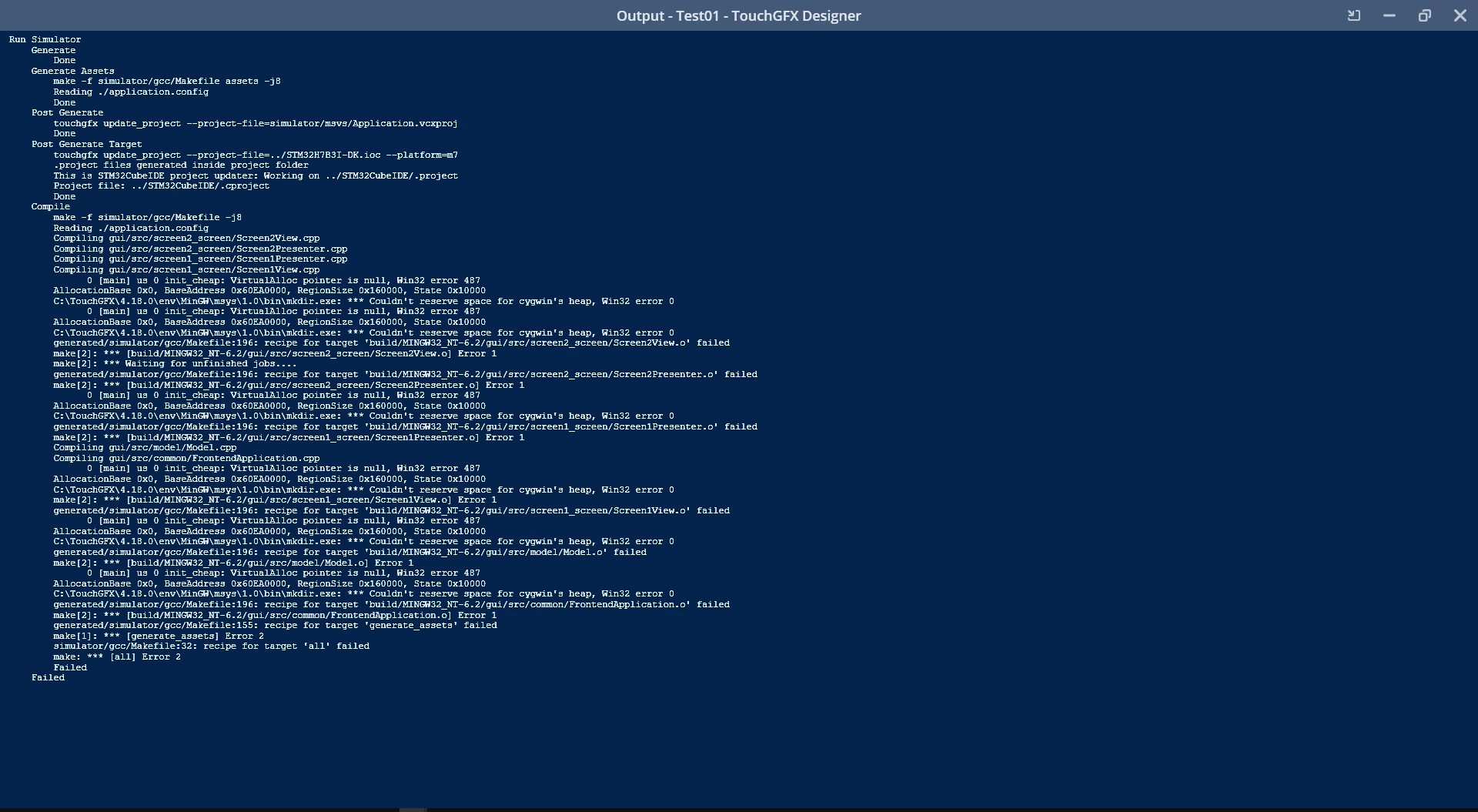

Compile error
0693W00000GZPIJQA5.pngI always show this message when I compile.
I tried to reinstall the TouchGFX 4.18.0 many times but it always same happened.
I tried to run in Windows 11 and Windows 10, but it is not changed.
I tried after removing the MS visual studio, but nothing changed.
I have STM32H7B3I-DK.
But it is the same happened when I try to PC simulate.
It has passed 2 weeks since I bought this kit.
But I can't proceed anymore because of this error.
I need support to solve this problem.

       0 [main] us 0 init_cheap: VirtualAlloc pointer is null, Win32 error 487
    AllocationBase 0x0, BaseAddress 0x60EA0000, RegionSize 0x160000, State 0x10000
    C:\TouchGFX\4.18.0\env\MinGW\msys\1.0\bin\mkdir.exe: *** Couldn't reserve space for cygwin's heap, Win32 error 0
    generated/simulator/gcc/Makefile:196: recipe for target 'build/MINGW32_NT-6.2/gui/src/screen2_screen/Screen2View.o' failed
    make[2]: *** [build/MINGW32_NT-6.2/gui/src/screen2_screen/Screen2View.o] Error 1
    make[2]: *** Waiting for unfinished jobs....
    generated/simulator/gcc/Makefile:196: recipe for target 'build/MINGW32_NT-6.2/gui/src/screen2_screen/Screen2Presenter.o' failed
    make[2]: *** [build/MINGW32_NT-6.2/gui/src/screen2_screen/Screen2Presenter.o] Error 1

MM..1
November 30, 2021
In how directory is placed application, try short path without spaces for example c:/tproject/Myapp1
is on your disk free space,
try older version template if exist.
Charles Bang
November 30, 2021
I tried it, but it is the same.
I remove the 4.18.0 and installed 4.17.0, it was the same.
I tried other paths, it was the same.
Charles Bang
December 1, 2021

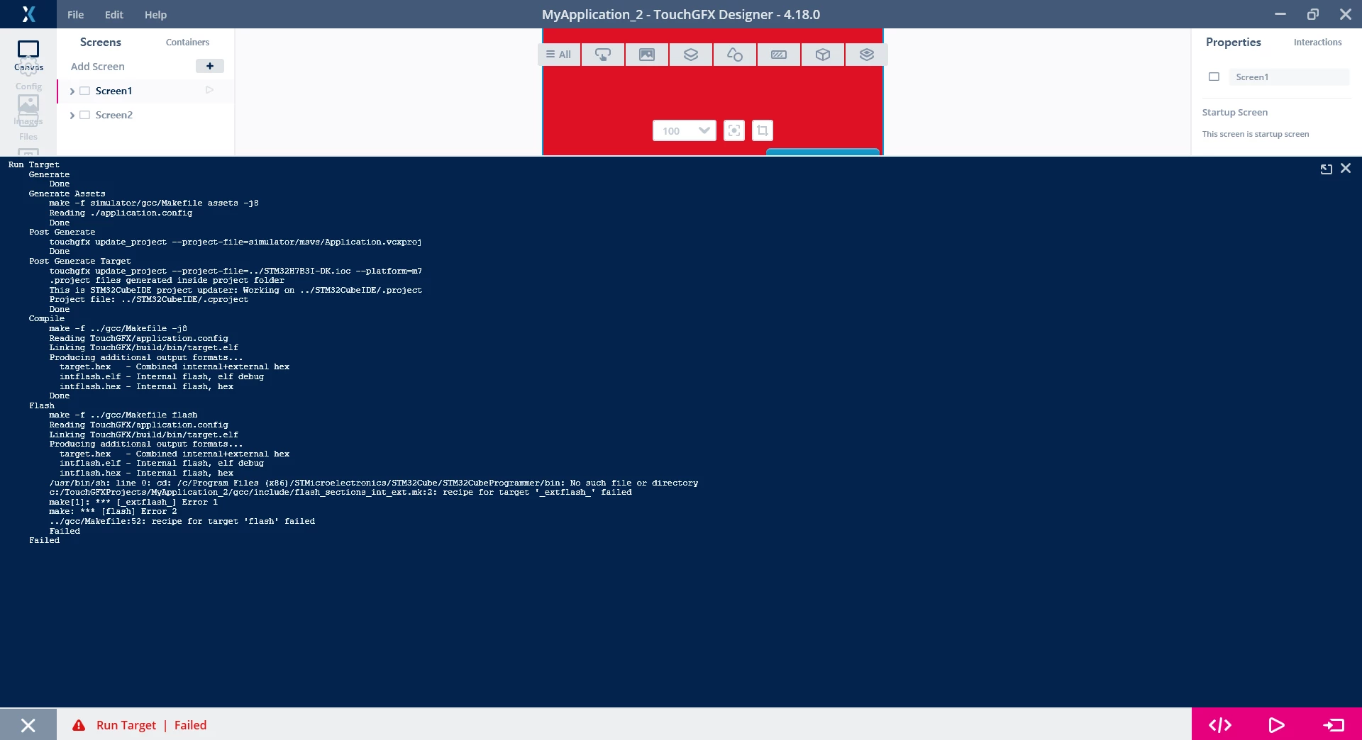

I solved this problem, but I have another problem again.
I found "rebase.exe" on the internet and copied it in the same folder with msys-1.0.dll.
And entered ".\rebase.exe -b 0x50000000 msys-1.0.dll".
It works now.
But I have another problem.
"Run Target" has an error now.​
Run Target
  Generate
    Done
  Generate Assets
    make -f simulator/gcc/Makefile assets -j8
    Reading ./application.config
    Done
  Post Generate
    touchgfx update_project --project-file=simulator/msvs/Application.vcxproj
    Done
  Post Generate Target
    touchgfx update_project --project-file=../STM32H7B3I-DK.ioc --platform=m7
    .project files generated inside project folder
    This is STM32CubeIDE project updater: Working on ../STM32CubeIDE/.project
    Project file: ../STM32CubeIDE/.cproject
    Done
  Compile
    make -f ../gcc/Makefile -j8
    Reading TouchGFX/application.config
    Linking TouchGFX/build/bin/target.elf
    Producing additional output formats...
     target.hex  - Combined internal+external hex
     intflash.elf - Internal flash, elf debug
     intflash.hex - Internal flash, hex
    Done
  Flash
    make -f ../gcc/Makefile flash
    /usr/bin/sh: line 0: cd: /c/Program Files (x86)/STMicroelectronics/STM32Cube/STM32CubeProgrammer/bin: No such file or directory
    c:/TouchGFXProjects/MyApplication_2/gcc/include/flash_sections_int_ext.mk:2: recipe for target '_extflash_' failed
    make[1]: *** [_extflash_] Error 1
    make: *** [flash] Error 2
    ../gcc/Makefile:52: recipe for target 'flash' failed
    Failed
  Failed
