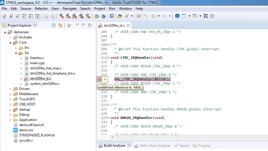

Hello all,
We are working on STM32F429 Discovery board.
Following are the steps we followed to create a project in TrueStudio using CubeMX and TouchGFX

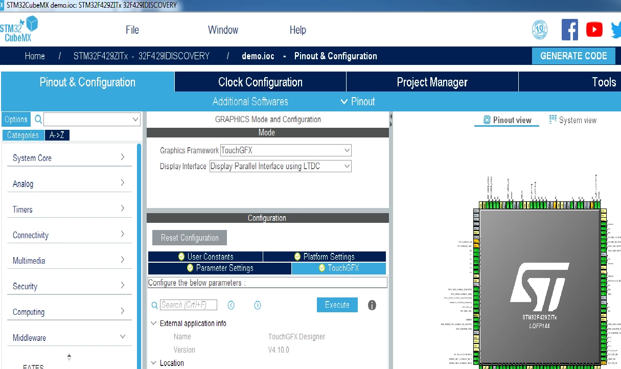

  1. Create a project in CubeMX by defining STM32F429 Discovery board .
  2. Do the configuration in GRAPHICS as shown in the screenshot as an attachment herewith
  3. Generate the code
  4. Open TouchGFX project throuch "Execute" button on the same screen
  5. Add a simple image in TouchGFX
  6. Generate the code in TouchGFX
  7. Again open CubeMX and generate the code in TrueStudio

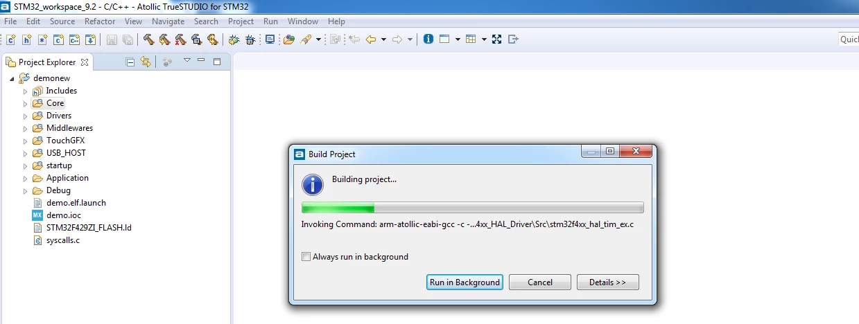

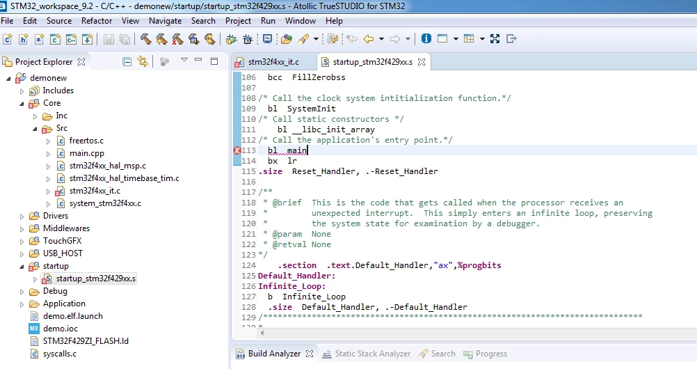

  8. Compile the project created in TrueStudio containing CubeMX with UI created in TouchGFX
But this results in compilation and linking errors as shown in below screenshots0690X000006D68XQAS.png
 Please help me with the solution to above errors
UPDATE:
One more change I did in testing today.
  1. Create a CubeMX project with GRAPHICS enabled
  2. Generate the code and compile it in TrueSTUDIO without any touchGFX interface attached to it.
RESULT: Same compilation errors as above
There are no compilation/linking errors without GRAPHICS enabled.

Markus GIRDLAND
January 16, 2019
The TouchGFX+CubeMX+TrueSTUDIO integration is not complete. This first implementation was not really intended for TrueSTUDIO so I would doubt that it would work out of the box.

kvkhekale
kvkhekaleAuthor
January 17, 2019
Thank you very much for the answer.
Now my project has successfully built and running on the board.
Will still have to make some changes in graphics settings to get the best image result, though.
FSTKMARO
January 16, 2019
Note that you will have to tweak your display clock in cubemx for the stm32f429 to work. I think it is all covered in the link that @Mon2​  indicated above.
