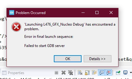

hello. I set STM32L476 disco with X-NUCLEO-GFX01M1 together and I want to take an example from touchGFX designer that is planed to run on STM32L496G disco and run the example on the combination I have. this because I will have a custom board with STM32L476 and a screen like X-NUCLEO-GFX01M1. how can I coordinate between the example and the combination I have ?

If it is only the GUI part you wish to migrate from a project to another you can use the "Import GUI" option under the "Edit" tab in TouchGFX Designer.

Hi Roamain,
Many Thanks for sharing STM32L496_X_nucleo_AT but after building with zero errors I am getting error when I am going into debug mode. ( please below picture )
0693W00000BcSnkQAF.pngI think as in previous case MX25L6433F_STM32L4_NUCLEO, 0x90000000, SPI_FLASH, MX25L6433F_STM32L4_NUCLEO.stldr is missing but as prescribed for STM32G071RB case I am unable to find gcc folder in your workspace from where I can copy this file to cubeide, but please advice me how to resolve this issue.
Other point I observed that when I am opening touch gfx designer from L476_GFX_Nucleo_80MHz\L476_GFX_Nucleo\TouchGFX I found that there is no option for run target, and due to this I am unable to upload and run the target form there also.

hello.
with the board I use, when I try to run L476_GFX_Nucleo I get :
Error in final launch sequence:
Failed to start GDB server
Error in initializing ST-LINK device.
Reason: (-2147155971) Unknown. Please check power and cabling to target.

maybe it's a jumper issue ? I can't find user manual for the board : STM32L476 disco.
Romain DIELEMAN
June 15, 2021
I do not have that board but the error message seems to indicate that it could be a jumper issue. There should be a jumper on the power source, try to put it on something called STLK (for STlink).
/Romain
