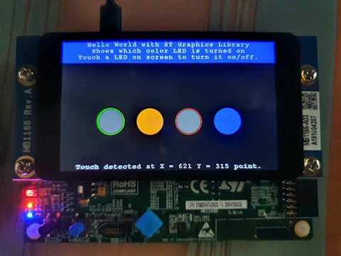

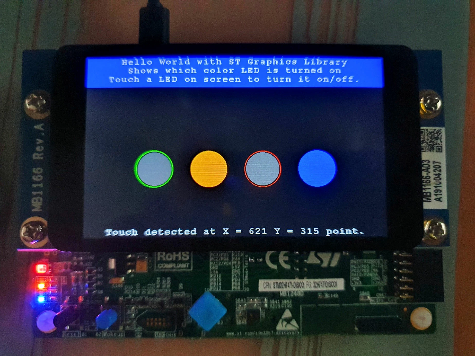

I imported stm32_lcd.c file from the official BSP example. I resolved a lot of include files, finally I could run the example, which simply worked. I have 4 LEDs on the LCD screen and touch X/Y position display in the bottom line. If I touch any LED it changes its state on the screen (turns it ON if it was turned OFF and reverse) and in addition it also turns ON/OFF the hardware LED on the DISCO board in synchrony with the LCD LEDS. On the attached photo the orange and the blue LEDS are turned on while the green and red LEDS are turned off.
0693W00000BdTlmQAF.jpgOf course, this app does not use STemWin library. Instead of the STemWin library it uses the functions implemented in stm32_lcd.c file, like UTIL_LCD_DisplayStringAt(), UTIL_LCD_DrawEllipse(), UTIL_LCD_FillEllipse() and many other functions.
Of course the STemWin library a very complex library with window handling and with other nice functions, but the stm_lcd.c “library�? is good enough to demonstrate how the display, buttons, interrupts work in STM32H747I-DISCO board.
If somebody has the same problem what I have then I suggest to use the stm_lcd.c file. Open/Import the STMicroelectronics “BSP�? project. Find the “Utilities/stm_lcd.c�? file and import it into your project. Resolving the include files is a nightmare, but it is not mission impossible.
This test proved that the board is good, the LCD refresh error is not hardware error. The bug is somewhere in the STemWin library. Most like in the ARGB8888 color handling.
