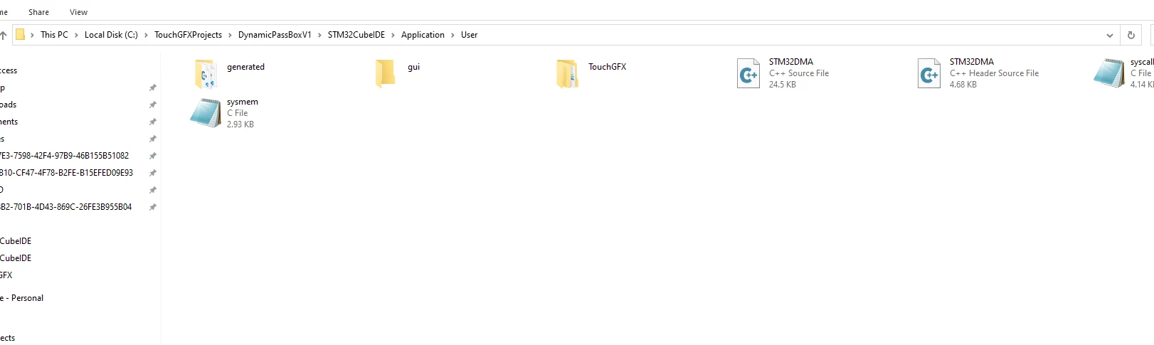

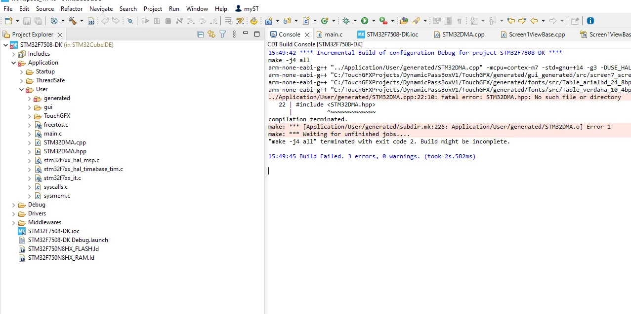

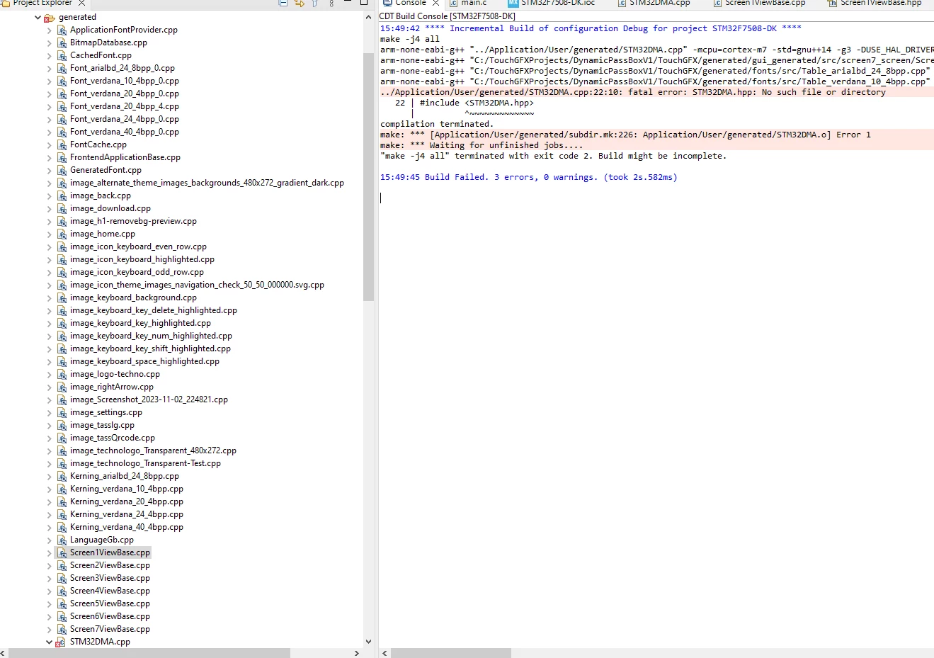

    i am created thread  StartTaskLed, when  i configure led i fot error
    ../Application/User/generated/STM32DMA.cpp:22:10: fatal error: STM32DMA.hpp: No such file or directory
     can you solve these problem i am attaching my code hear
