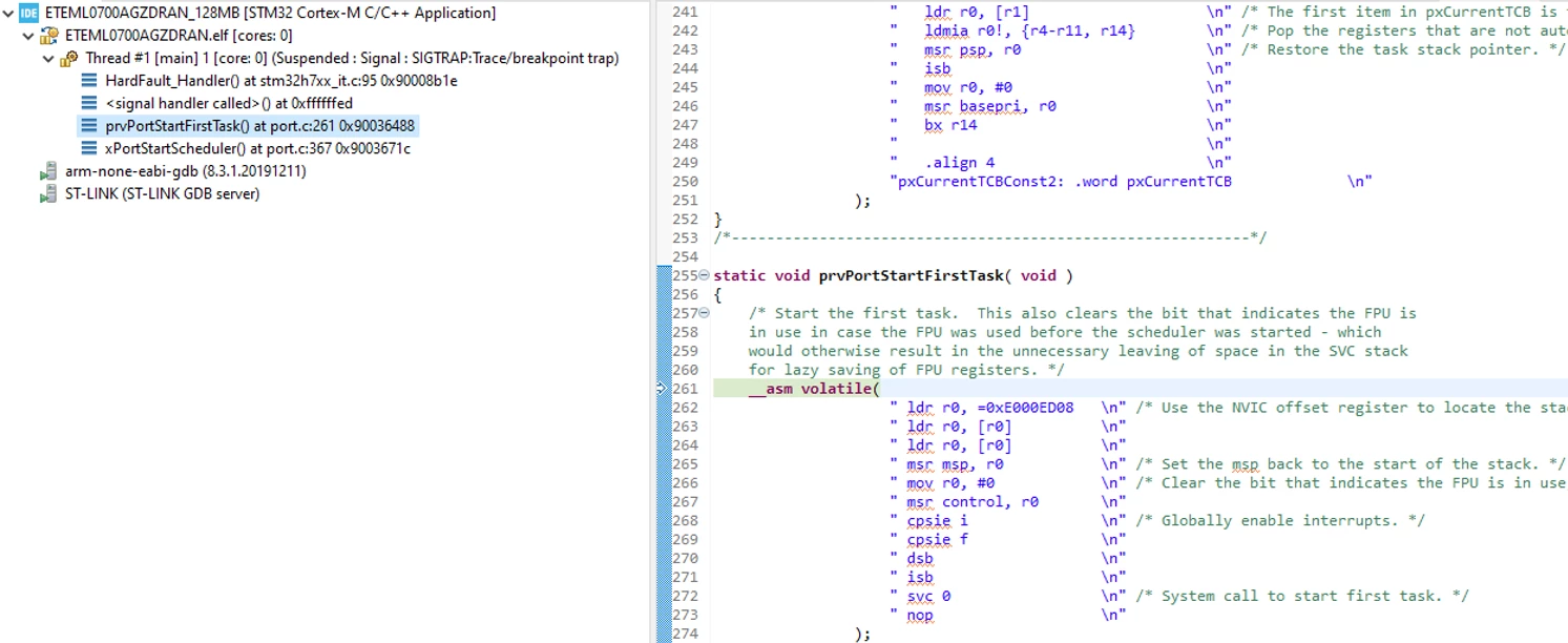

To understand where the problem comes from, I have strongly lightened my code by keeping only 2 screens and the minimum of code possible but the debugger still does not work.
When I launch the debugger, it gets stuck on a Hard Fault in FreeRTOS that you can see in the image below.

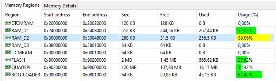

I am wondering if the debugger needs to use MCU's memory to run ?
If so, maybe it is the cause of my problem as I can see the following memory usage as below:
0693W00000NqcfmQAB.pngDo you have any idea why the debugger doesn't work?

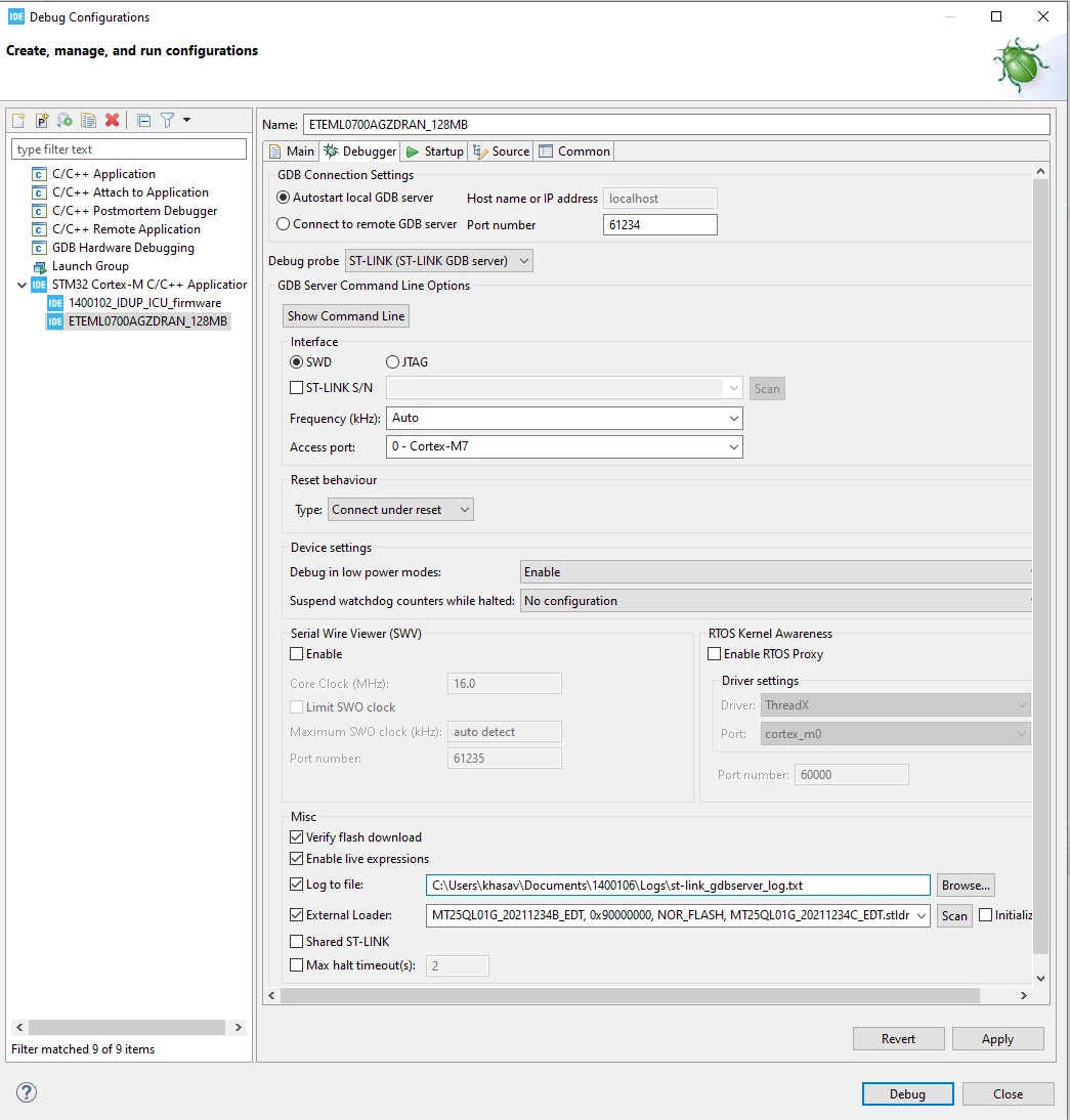

May 30, 2022
Here is my debugger configuration that works with small project but not on big one:
