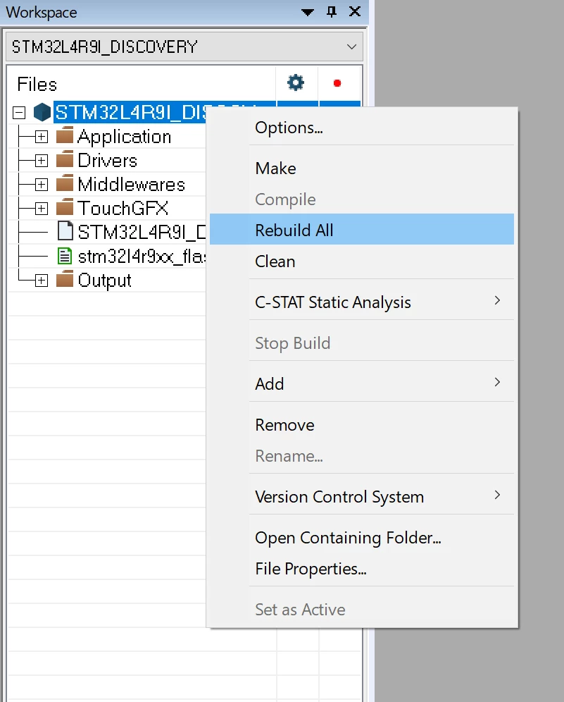

You have to compile your project to see your .map file.
If you are using STM32CubeIDE, please press the "Build" button :
If you use EWARM, press "Rebuild all" after right-clicking your project name :
If it compiles successfully, you'll be able to access your map file.

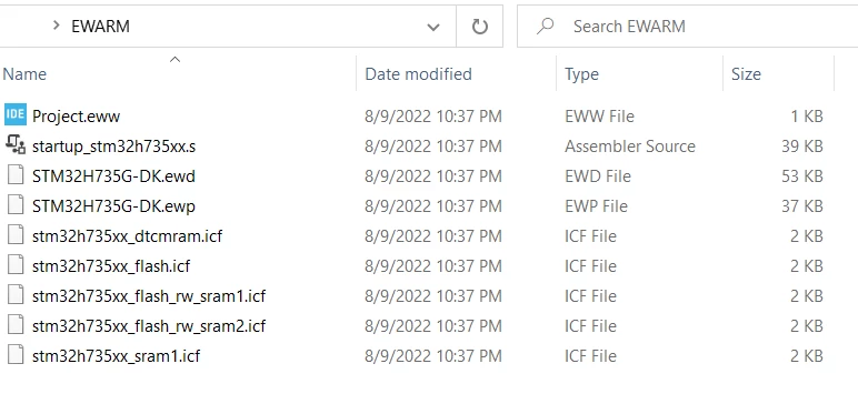

ksale.1
ksale.1Author
Senior II
Aug 10, 2022 1:49 AM UTC
Thank you @Yoann KLEIN​
Please note the EWARM directory in my case (gfx 4.20.0)
