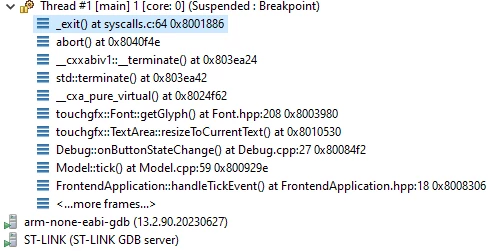

Thanks for the quick reply. I don't know how to get the stack call since the program didn't crash but actually navigated to an infinite loop. I am not familiar with CubeIDE.
I tried to call the goto____NoTransition function from a presenter and it went to the infinite loop again.
The thing I forgot to say is, actually the screen transition happens. I can see the new screen on my display then nothing responds. When I pause the program using IDE, I can see that it is in syscall.c -> _exit function.
I placed a breakpoint to my line:
static_cast<FrontendApplication*>(Application::getInstance())->gotoScreen2ScreenNoTransition();
Then I moved step by step and when I got to the _exit function, the list on the left side (I hope this is the stack trace) was like this:

What is on line 59 of the Model.cpp?

starcinAuthorBest answer
Dec 3, 2024 7:18 AM UTC
Somehow the problem was me calling resizeToCurrentText() function of TextArea.
Let me show you my whole Model.cpp
The line 59 is the line 52 here. Where I call something from debugWidgetPointer.

Looks like if I forget to implement the call for this bind function, the debugWidgetPointer is not null but simply points to a weird place (I guess?) and cause unexpected results. I think the only thing I need is a way to nullify these pointers when a screen change happens. Do we have a single place that is called everytime screen changes? Preferably somewere that can access modellistener or model?
EDIT: I tried to nullify them in modellistener's constructor but the code still exits if I don't bind the pointer.
