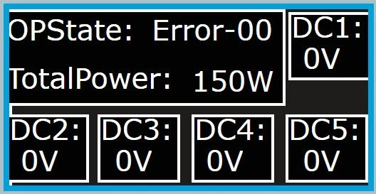

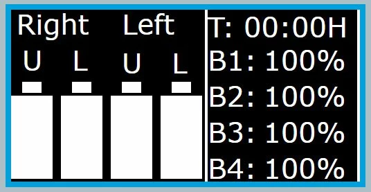

Changes require to display graphic on the vertical drawing pixel( vertical bytes orientation e.g. display driver SSD1309 etc.).

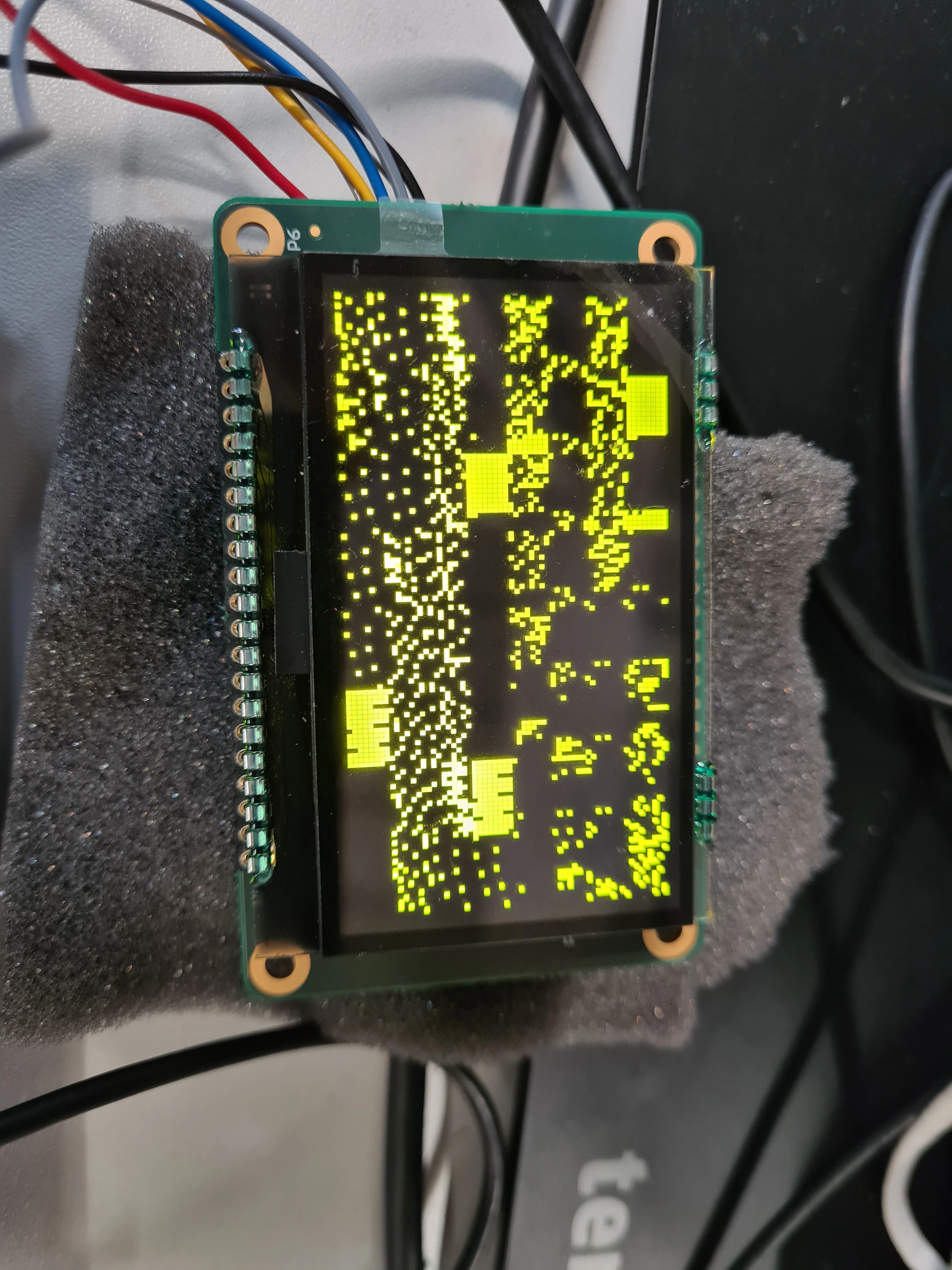

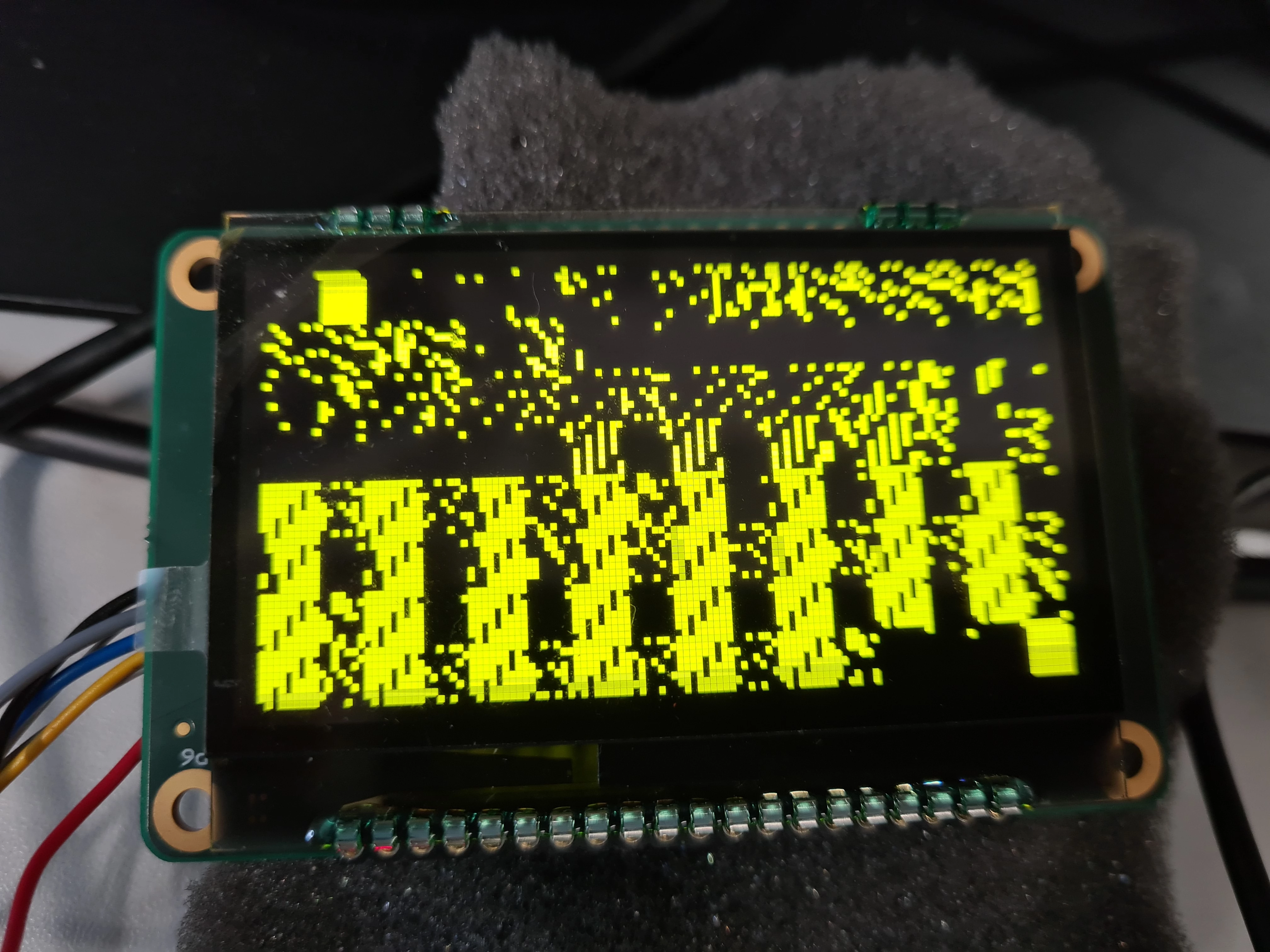

I have successfully implemented a complete graphic to display some system related parameter on a monochrome OLED Display with display driver SSD1322, which is a horizontal drawing pixel, however porting the same code to a monochrome OLED Display with display driver SSD1309 result in a gibberish (see the pics), it supposed to look like pics 1 & 2.
Is there any changes or function build in TOUCHGFX to transform the horizontal byte orientation to vertical byte orientation ?
