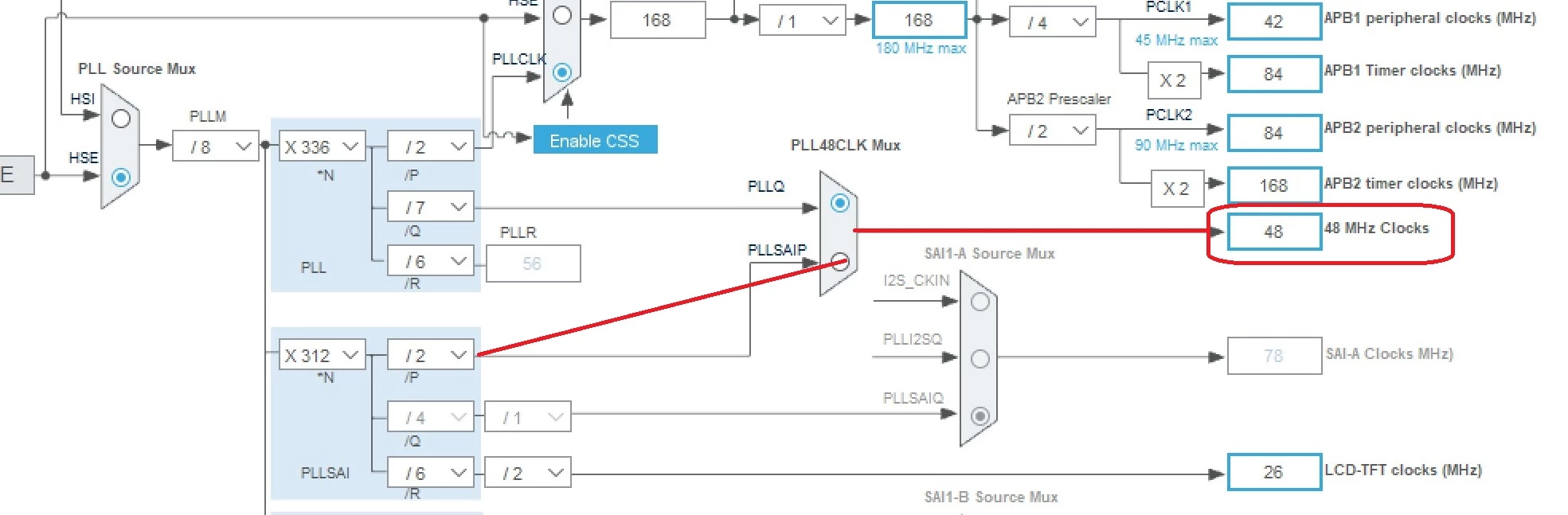

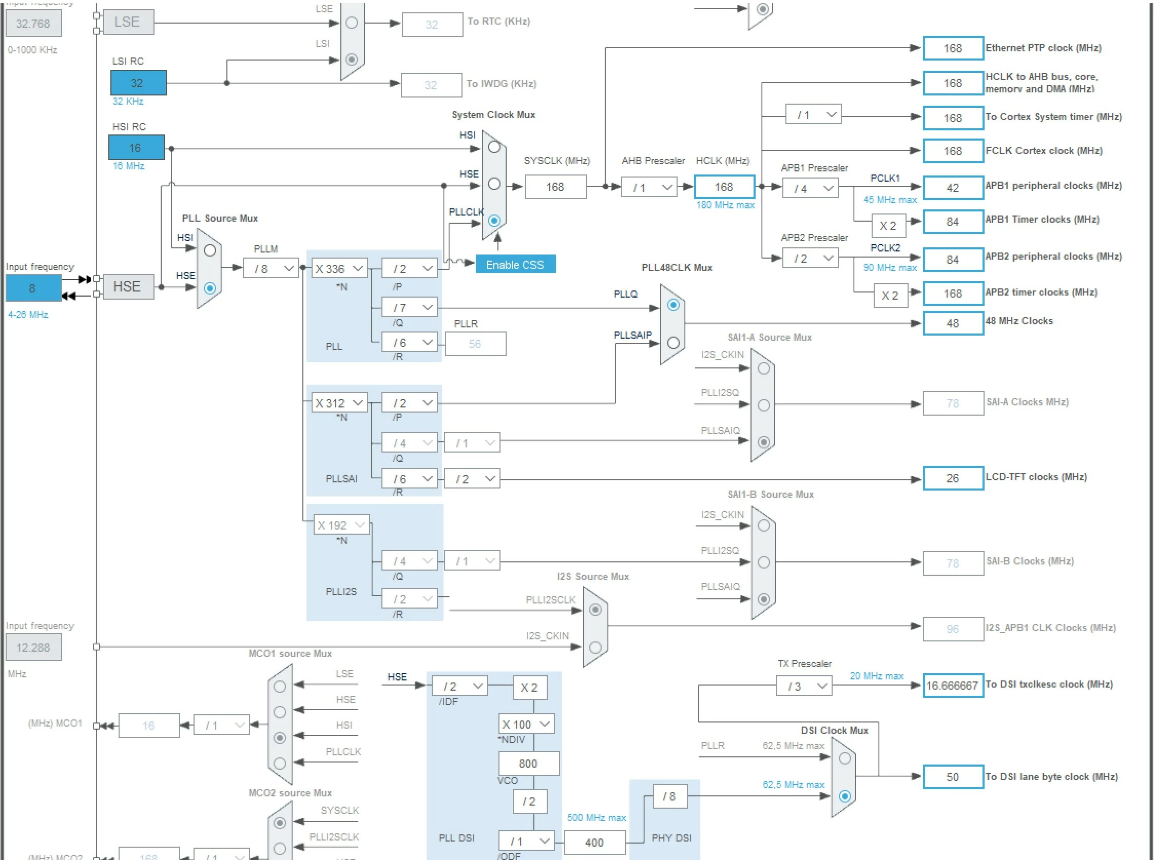

Yes, on 180 MHz i do not have any problems. But i need to activate the USB and this needs 168 MHz, so the only way to get that is this setup:
I tested fullscreen fades and smaller ones. On smaller ones the whole screen got some "flickers" during the fade. Wipe transitions are ok.

Can't you generate the 48 MHz clocks via the PLLSAI ?
Slow down the QSPI bus clock
hqspi.Init.ClockPrescaler = 1; // Make BIGGER, ie 2
waclawek.jan
Apr 13, 2022 1:41 PM UTC
If LCD_TFT clock could be lowered somewhat to 24MHz (I don't know what are the ramifications of this), 48MHz USB clock could be generated in PLLSAI, while retaining the 180MHz sysclk generated in "main" PLL.

Unfortunately my display works only perfect with 26MHz, i already tested for hours to play with the values of the display to get it working without strange behavior but i had no success.
