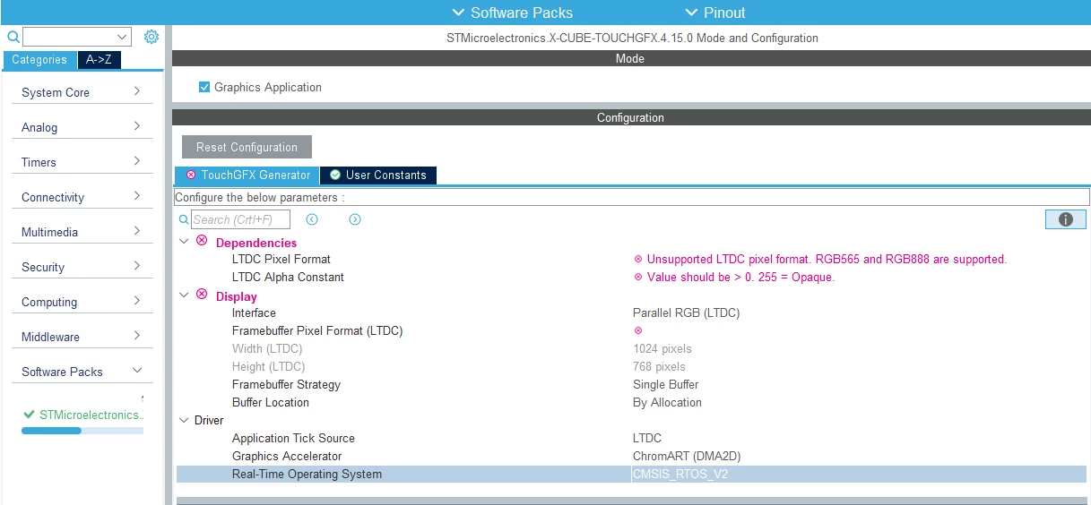

Import the project created using the STM32F769I-DISCO template with TouchGFX with STM32CubeIDE,
After setting the LCD clock with GUI
I disabled DSI in the GUI and set the parameters for LTDC and TouchGFX.
The HSYNC, VSYNC, and DE signals are now output, but they are out of sync with the color signals.
What should I do to get in sync?

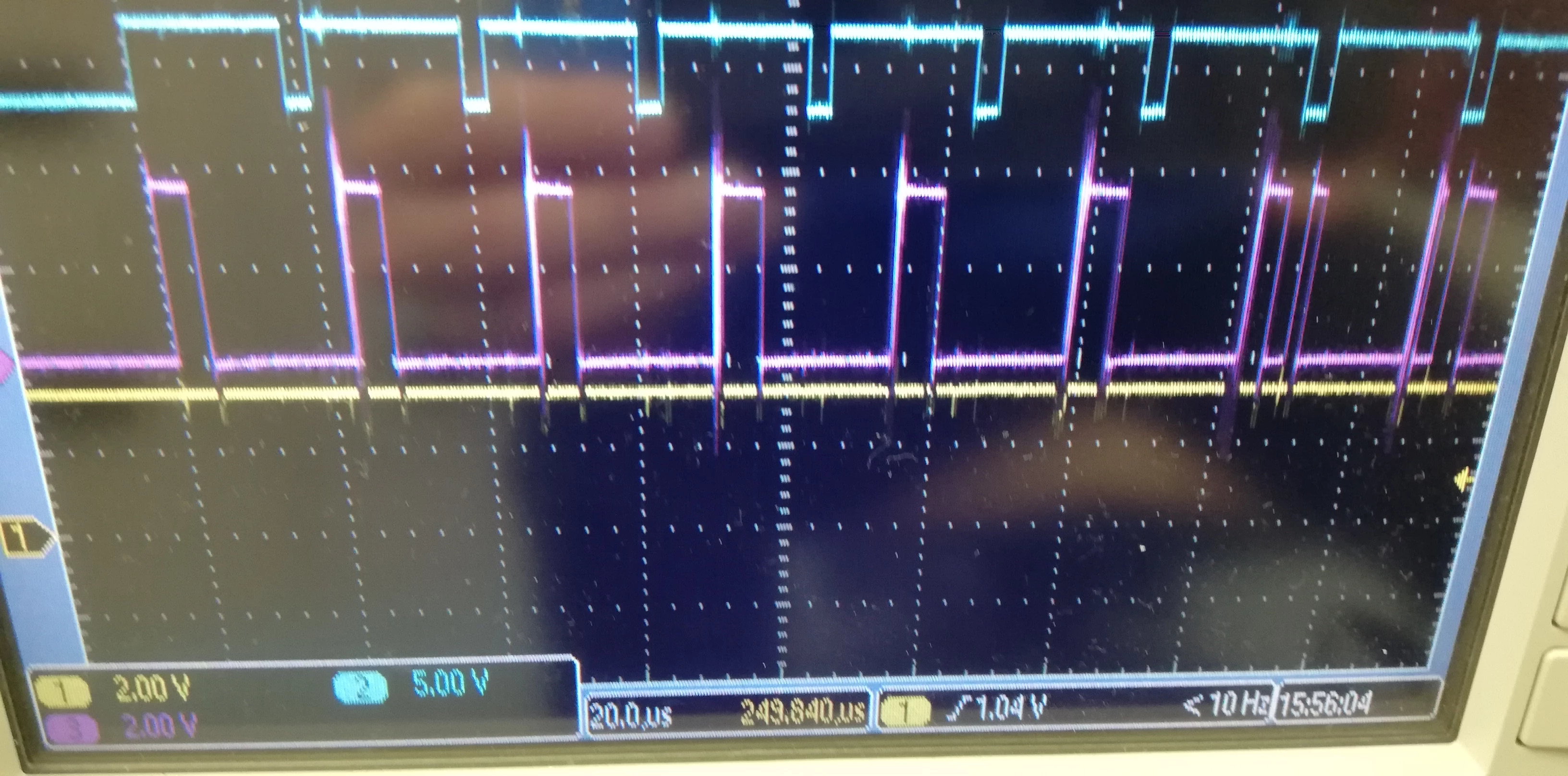

The waveform observed by the oscilloscope is attached.
A white image is pasted only on the left 1/4 of the screen.
Light blue (top) is DE and purple (bottom) is the R5 color signal.
You can see that it is shifting little by little.
Thank you.

This shifting is equal to horizontal sync porch intervals.
Edit: I make next see on your image and seems your config is not correct.
Maybe you setup quick dot clock and memory cant read at this speed...

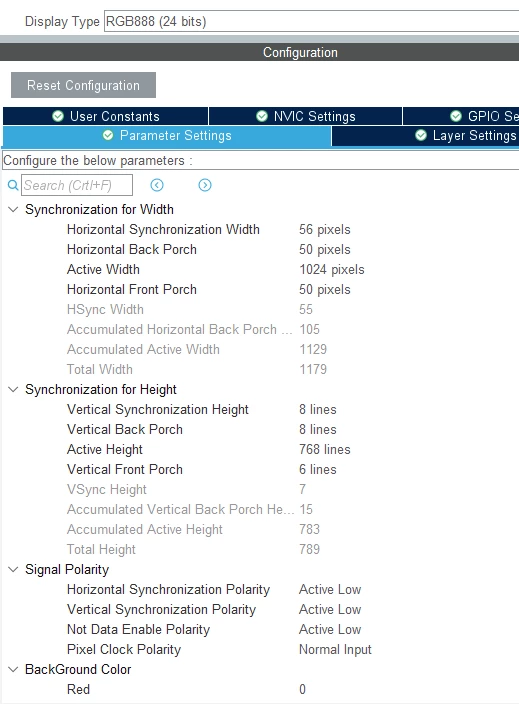

The LCD resolution is 1024 * 768.
Load the project created with TouchGFX with Cube IDE
I set the parameters according to the liquid crystal as shown in the attached image.
The LCD clock is 56MHz.
(At least 52MHz, so it can't be too slow)
I would appreciate it if you could tell me in detail where the problem might be.

When your custom board have SDRAM 32bit this clock can work , but with 16bit try 33MHz max

I created a project by selecting the template of STM32F769I-DISCO with TouchGFX Ver4.15.0.
I loaded the project with STM32CubeIDE, opened the ioc file and made the following settings using the GUI.
・ Set the LCD clock to 56MHz
・ Disable DSI
・Change to RGB parallel interface
・Set the Display Interface of TouchGFX to Parallel RGB (LTDC)
・Set TouchGFX Application Tick Source to LTDC
I'm going to start with a clean wizard.
Is it something wrong with the settings?
