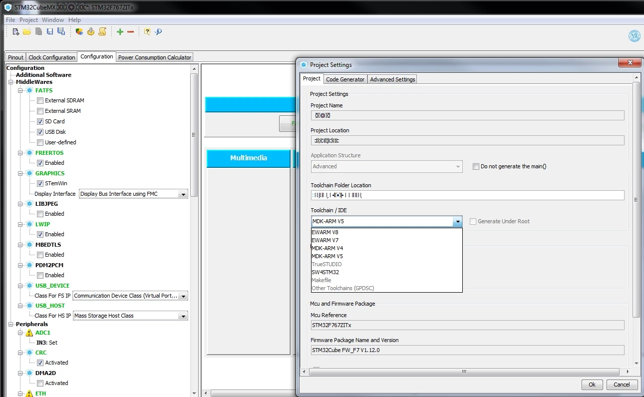

Cannot select TrueStudio IDE in STM32CubeMX with Graphics STemWin enabled. How to solve?
As soon as I enable STemWin in CubeMX, I cannot select TrueStudio IDE (see attached screenshot). In the forum, I found other posts with the information that this should work.
My CubeMX verion is 4.27.0 (downloaded installer yesterday and tried a new installation).
I use a STM32F767ZIT. Any idea what could be wrong?

Hello @Chris75​ ,
Effectively for STM32CubeMX 4.27.0 , it is not possible to generate project with TrueSTUDIO if graphics is enabled . stay tuned for 5.0.0 this week Grpahics will be OK with TrueSTUDIO :smiling_face_with_smiling_eyes: .

Hi @Chris75​ ,
I assume the limitation is related to the STemWin library (although the GCC compiler is already supported by the library). This limitation will be reported internally to keep you informed by when it will be possible to generate graphic project with TrueSTUDIO.
As workaround, I think that you should be able to generate the project with SW4STM32, then port it to TrueSTUDIO.
-Amel
PS: Stay tuned to use the new STM32CubeMX version, and keep us informed about your feedback.

Hello Amel and Houda,
Thank you for your quick answer!
I started to implement STemWin by hand, but will try CubeMX 5.0.0 also, as soon as it's available.
