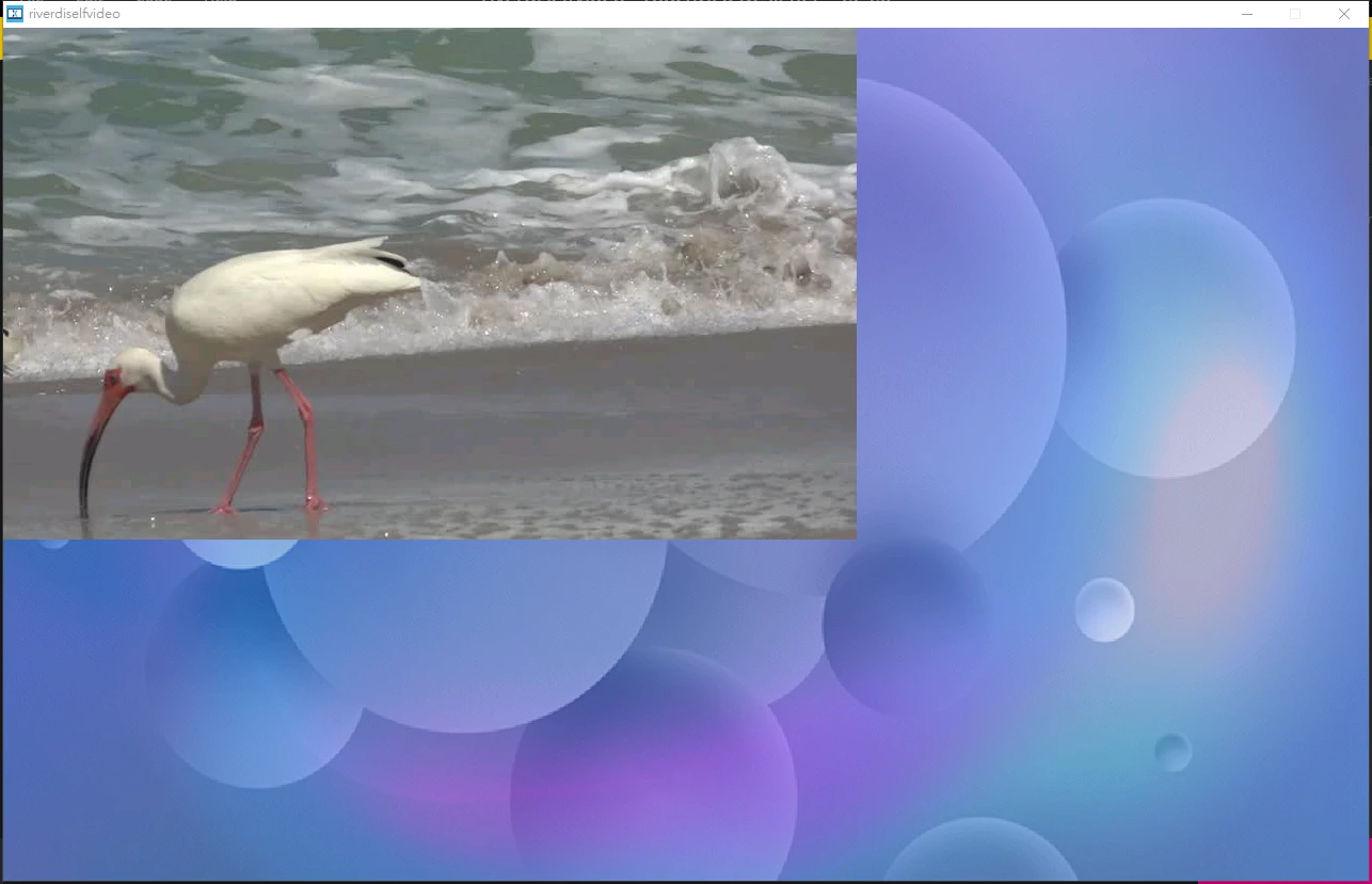

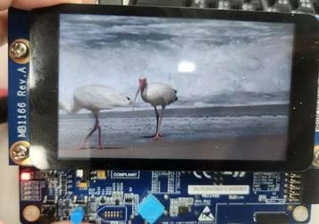

I am using the TouchGFX video widget to play custom videos on the STM32H747I-DISCO development board. I am able to play videos by placing them in the assets/videos folder and modifying Screen1View.cpp as described in the MJPEG Video . The video playback works as expected on this board, as shown in the the image below.
However, when using non-ST development boards, such as the Riverdi-RVT101HVSNWC00-B and my custom development board, I encounter issues. The video widget does not display the video, even though it works in the simulator with TouchGFX. The screen remains blank.
TouchGFX simulatorTouchGFX simulatorVideo not show on screenVideo not show on screen

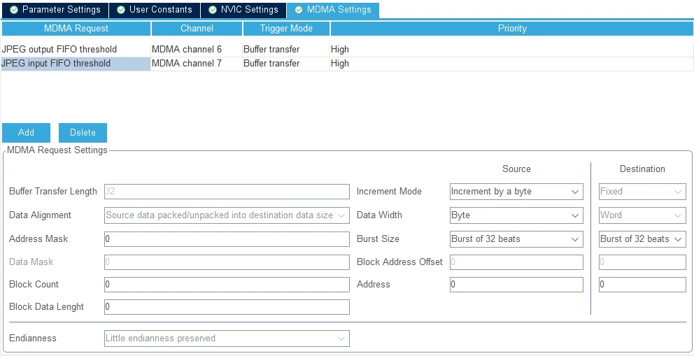

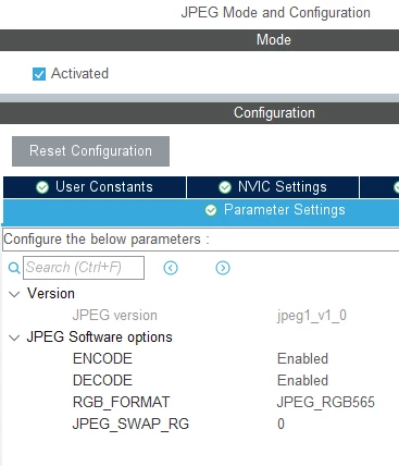

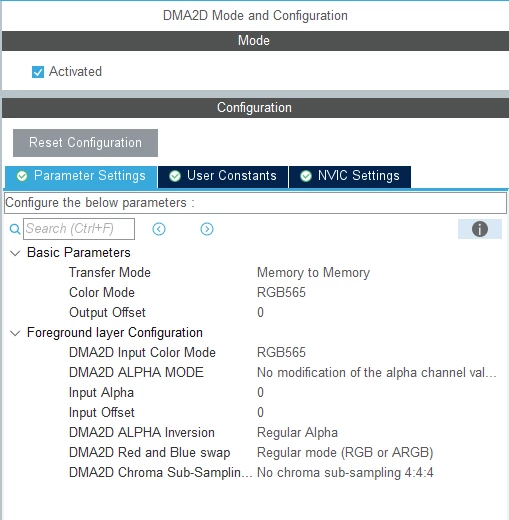

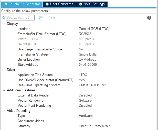

Aug 26, 2024 2:32 AM UTC
Hello @Mohammad MORADI ESFAHANIASL ,

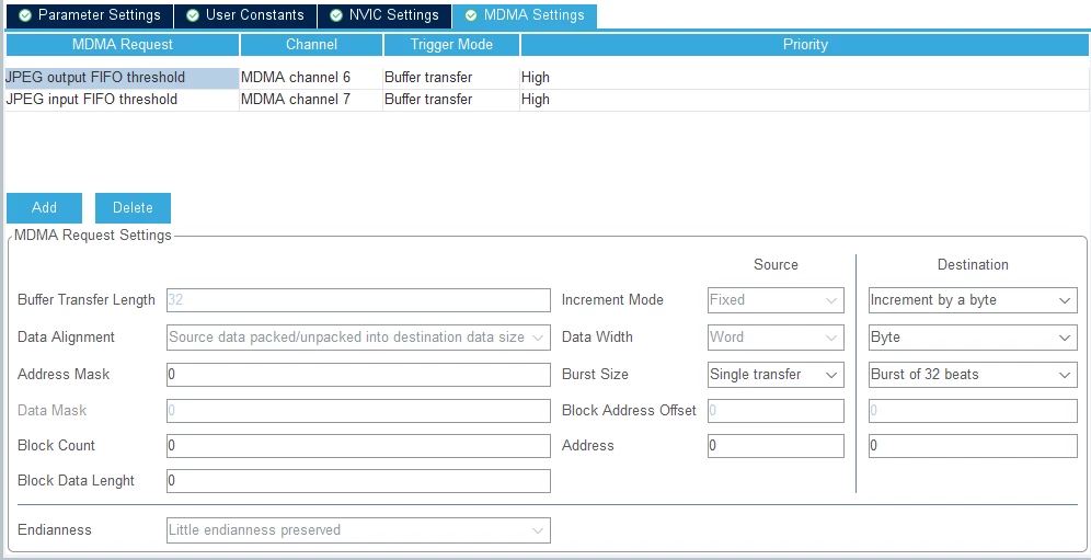

  I followed the steps and am using a custom development board with the MCU STM32H743BGTx.
The TouchGFX framebuffer is set to single buffer, and video decoding is set to hardware/direct to framebuffer, so there is no need to create a videoTaskFunc() in the RTOS.
  This setting works with the Riverdi-RVT101HVSNWC00-B, but it doesn't work on the custom development board. Strangely, if I set video decoding to "Disable," the TouchGFX screen displays correctly on the monitor. However, when set to "Hardware," the screen turns completely black.How can I do to my custom development board?
TouchGFX settingTouchGFX setting
ChungEN_1-1724639368189.pngChungEN_2-1724639402575.pngChungEN_3-1724639456048.pngChungEN_4-1724639479327.png
Aug 28, 2024 12:13 PM UTC
Hello @ChungEN,
Is it possible to share your project? Or at least, please share the TouchGFXHAL (both .cpp and .hpp) and TouchGFXGeneratedHAL both (.cpp and .hpp)
