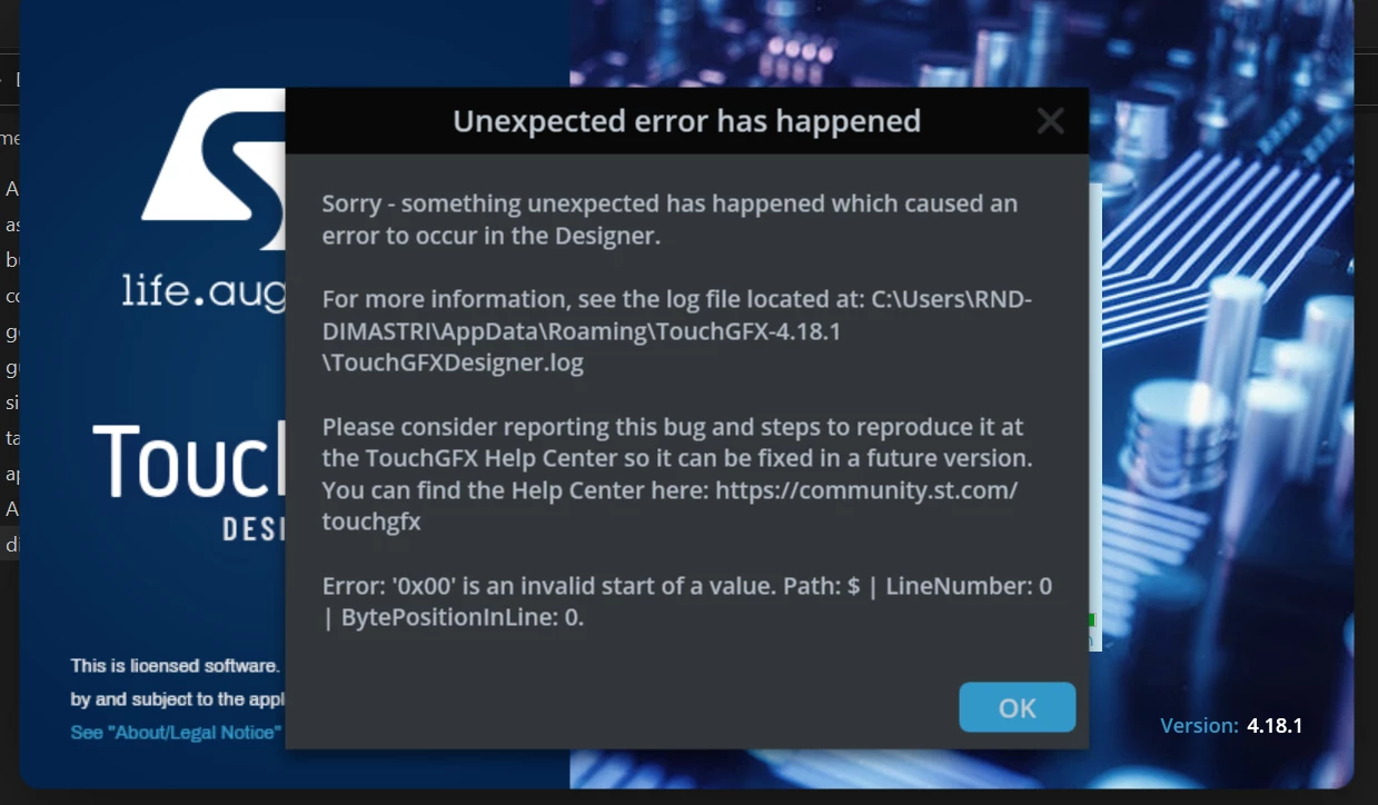

Cannot open Touchgfx 4.18.1 Designer
Hello, I have trouble cannot open apps Touchgfx 4.18.1 Designer in Windows. Any Solution? Thanks you

Hello @DPutr.1 ,
Could you send us the log file located at the path mentioned in the error message please?
Also, we would recommend you to use 4.22.0 version of TouchGFX that we released yesterday :) It's much more stable, and complete solution than the 4.18.1. Take a look at this post.
/Osman

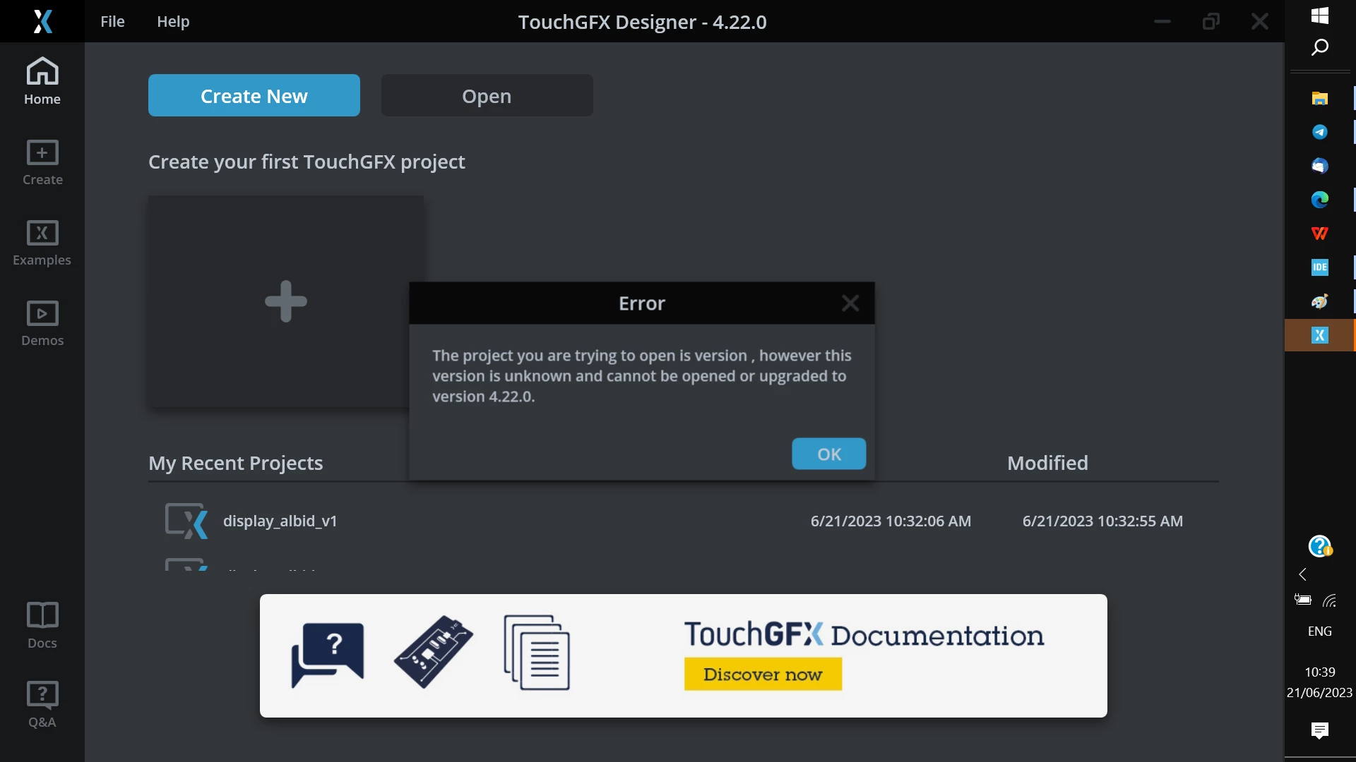

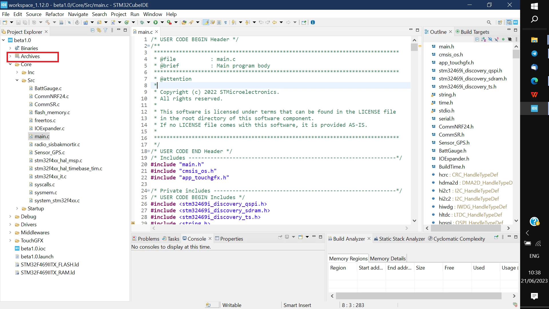

DPutr.1
DPutr.1Author
Jun 21, 2023 3:41 AM UTC
previously it worked , yesterday I was in debug mode to see the program run . suddenly my laptop blue screen and restart again. when I use it again it looks like this (I attached the view to stm32cubeide) and the touchgfx and apps files can't be used. any suggestions?can it be fixed?
Osman SOYKURT
Jul 3, 2023 9:48 AM UTC
I don't know what happened here, but it seems that the upgrade didn't complete properly. You can maybe try to revert your project to its original version if you version controlled it and try to upgrade again. Else, you could open the touchgfx file with a text editor and manually type the touchgfx version in it (last 3 lines of the file).
