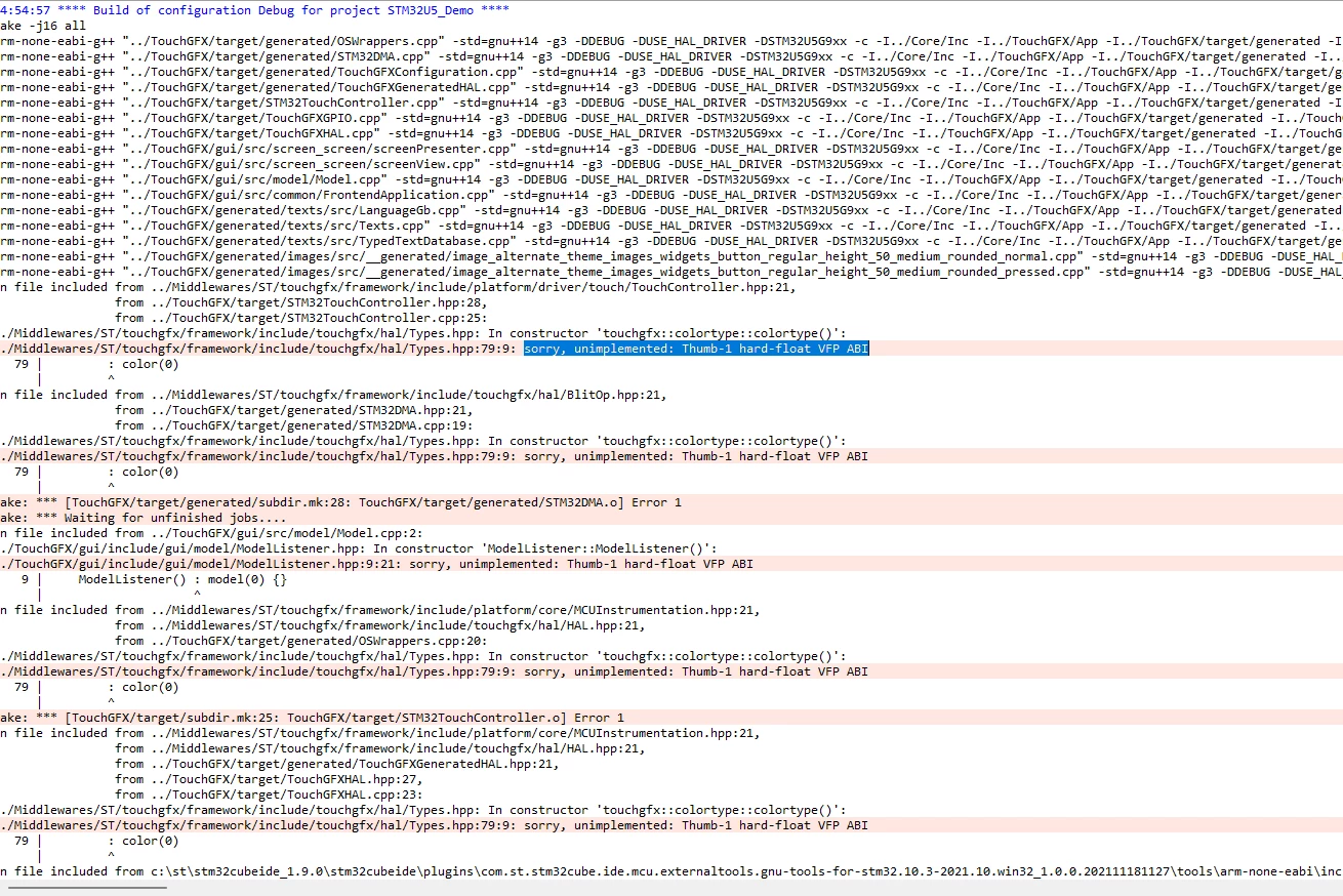

Cannot compile STM32U5G9J-DK2 project when created with CubeMX
I have generated code for STm32U5G9J-DK2 via cubeMX, included FreeRTOS and touchGFX designer middleware. Once I compile I get error "sorry, unimplemented: Thumb-1 hard-float VFP ABI" from multiple locations (total 29 errors). I ma not sure what I am missing or the root cause of these errors.

Hello @f_rehman ,
When I googled your error message, I found multiple people having solved it by modifying their build options :
 - https://github.com/frida/frida/issues/311
 - https://www.openstm32.org/forumthread660
 - https://www.openstm32.org/forumthread3099
You might want to check your compiling options.
Furthermore, you could compare your project with one of our TBS.
I would also like to add that, since you use U5G5 discovery, you could just create a project directly from Designer and them open the ioc file to modify whatever you want.
Tell me if that helped you.

f_rehmanAuthorBest answer
Apr 16, 2024 2:09 PM UTC
Somehow updating the cubeIDE to 1.15 fixed the issue. I did checked the compiler options and microcontroller settings, everything looked good. Anyways, IDE update fixed my issue.
