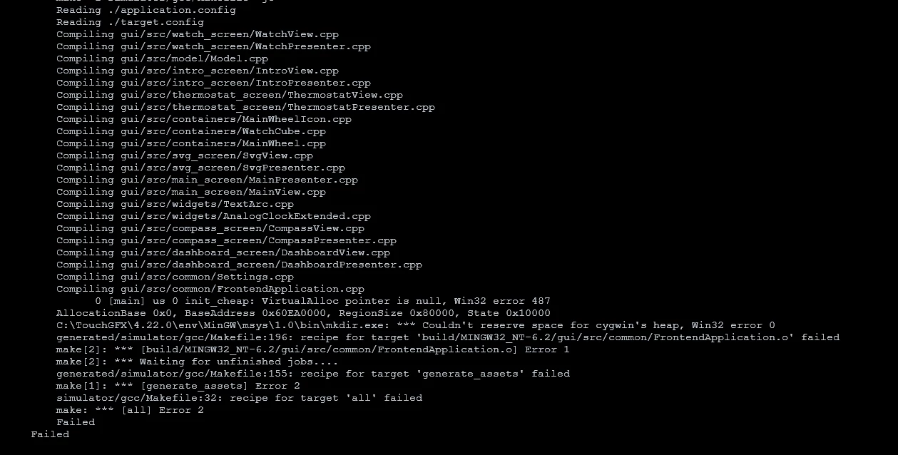

When I'm building some of the demo projects, I often have this build error, which other developers have already reported in this community.
And I followed the instructions on this link, and "patched" the msys-1.0.dll which is causing this crash at build (i opted for editbin.exe in the end).
According to some discussions on previous link, this issue has been solved within MSYS 2.0.
Are there any plans from ST to move to MSYS 2.0 within TouchGFX, to avoid this issue again?
Every time there's an update of TouchGFX, I need to manually patch this .DLL again.
Solving it once for all for everyone would be a much better solution.

Hello @apadom,
We are aware of this problem, and we plan to fix it in a future release. Unfortunately, I cannot promise you when or for which release it will be fixed, it depends on our other priorities.
Sorry for the inconvenience.
Thanks for your report.
