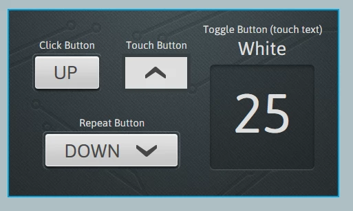

I'm building a program which has a part that is similar to the "Flex Button Example".
In my case I've got a problem with Unicode. My program works the same as the image above. When I reach to number 24, 26, 28, 29, this is what it shows:
This is my code:

And then, when I print the number through the TouchGFX Terminal, it works fine:
I would appreciate your help.

Looks like the glyphs are missing. "?" is the default fallback character when TouchGFX can't find the glyph.
By default TouchGFX only includes the glyphs, from the font, that are required. When using wildcards you need to tell TouchGFX which glyphs it should include.
This is done in the Designer under typographies. I think it's called "wildcard ranges".
It's mentioned in this article: https://touchgfx.zendesk.com/hc/en-us/articles/207015345-Using-texts-and-fonts

It worked, that was the problem.
Thanks a lot!
