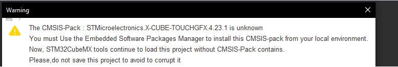

Hi, got a problem opening the .ioc.
It shows me this error.

The TouchGFX installation will not install anything to STM32CUBEIDE or STM32CUBEMX.
You can install in these environments from the Internet or use what you downloaded and installed. Select the TouchGFX installation file packaged in the local storage.
Help / Manage Embedded Software Packages
STMicroelectronics
X-CUBE-TOUCHGFX
install version 4.23.1

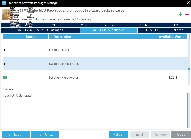

It only shows version 4.22.1 as the lastest.
What can I do to get that version?

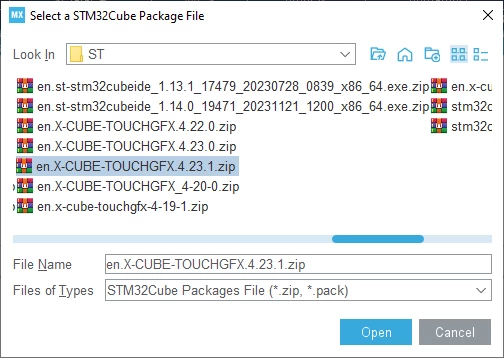

Hi
I guess you have allready download th 'en.X-CUBE-TOUCHGFX.4.23.1.zip'. Just press From Local and browse the zip file.
Latest version is not yet available thru the CubeMX package manager directly.

Here:  https://www.st.com/en/embedded-software/x-cube-touchgfx.html
Click on "Get software". On this page click on Select version and select 4.23.1.

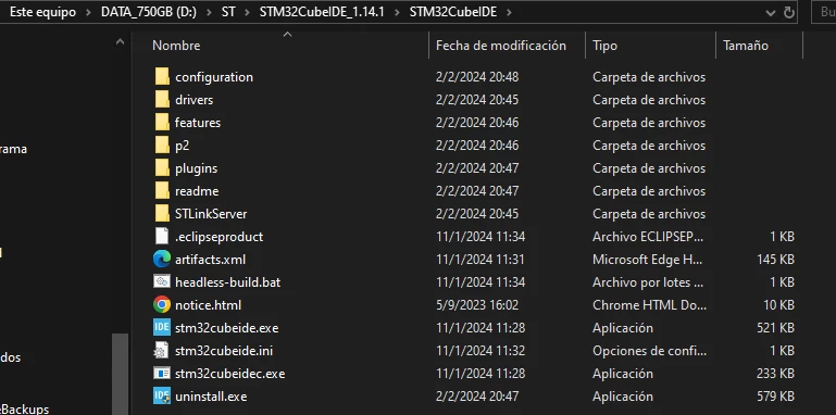

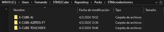

Ok and what file should I put the .zip in? Cause I tried in the repository but the IDE gave me an error.
I got another ST folder on another disk but I don't know.

so from the beginning. Apparently, you have STM32CUBEIDE or STM32CUBEMX installed, but you don't have the TouchGFX extension installed there. You have to download this here (Get latest):
https://www.st.com/en/development-tools/touchgfxdesigner.html
You must log in (register). After downloading this package, don't unpack anything and use this package to install extension To STM32CUBEIDE, STM32CUBEMX (both applications share the same space, just install to one) "en.X-CUBE-TOUCHGFX.4.23.1.zip". You can then install the TouchGFX environment itself after unpacking the downloaded package. You can find the installation in the folder "Utilities\PC_Software\TouchGFXDesigner\"
